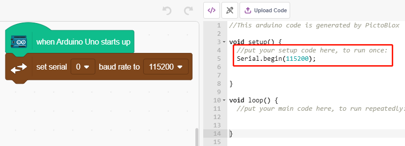

2. Initializing the Arduino Uno and Serial Monitor
In Upload mode, start Arduino Uno and then set the serial port baud rate.
  • [when Arduino Starts up]: In Upload mode, start Arduino Uno.
  • [set serial baud rate to]: From the Communications palette, used to set the baud rate of serial port 0, default is 115200. If you are using Mega2560, then you can choose to set baud rate in serial port 0~3.
../_images/11_init.png
