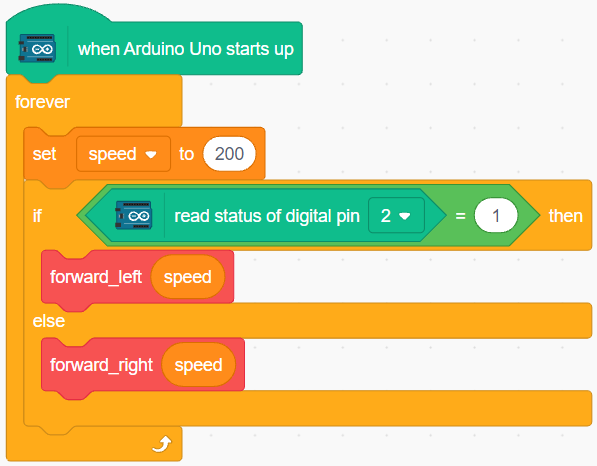

3. Line Tracking
Read the value of Line Tracking module, if it is 1, it means black line has been detected, let the car move forward to the left, otherwise move forward to the right.
../../_images/3_follow.png
After uploading the code to the R3 board, then align the Line Tracking module under the car with the black line, and you will see the car following the line.
