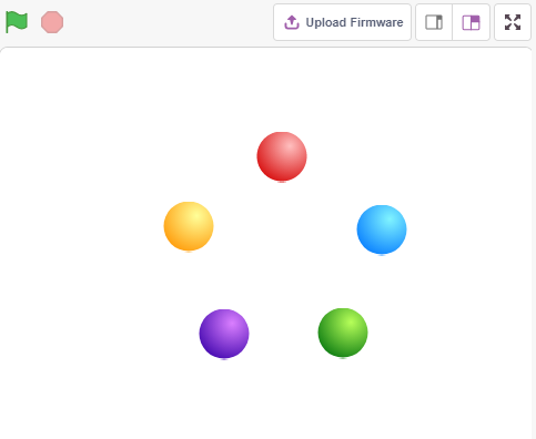

In this project, we will make the RGB LEDs display different colors.
Clicking on different colored balls on the stage area will cause the RGB LED to light up in different colors.

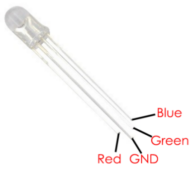

An RGB LED packages three LEDs of red, green, and blue into a transparent or semitransparent plastic shell. It can display various colors by changing the input voltage of the three pins and superimpose them, which, according to statistics, can create 16,777,216 different colors.
../_images/4_rgb.png ../_images/rgb_circuit.png

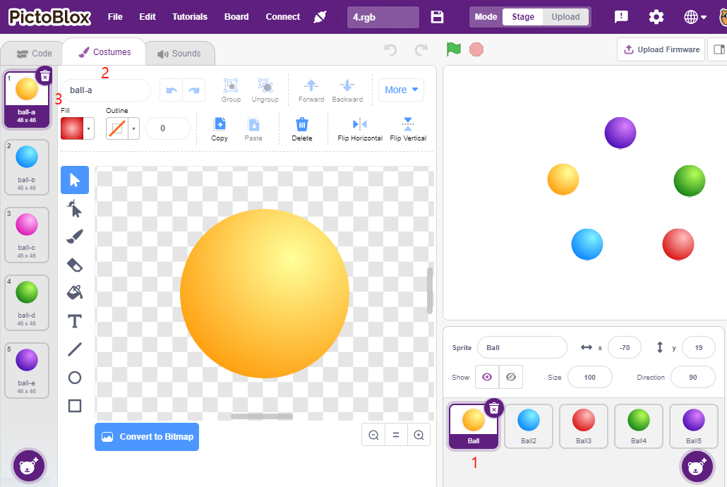

1. Select sprite
Delete the default sprite, then choose the Ball sprite.
../_images/4_ball.png
And duplicate it 5 times.
../_images/4_duplicate_ball.png
Choose different costumes for these 5 Ball sprites and move them to the corresponding positions.
Ball3 sprite costume color needs to be manually changed to red.
../_images/4_rgb1.png

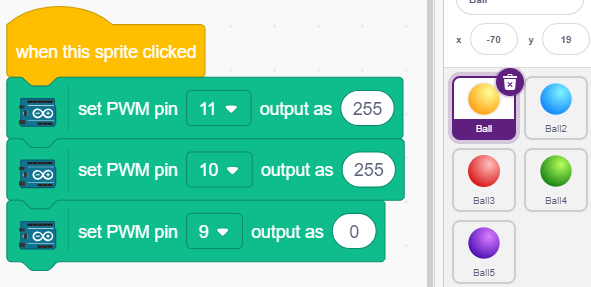

So the code to make the RGB LED light yellow is as follows.
../_images/4_yellow.png
When the Ball sprite (yellow ball) is clicked, we set pin 11 high (red LED on), pin 10 high (green LED on) and pin 9 low (blue LED off) so that the RGB LED will light yellow.
You can write codes to other sprites in the same way to make the RGB LEDs light up in the corresponding colors.

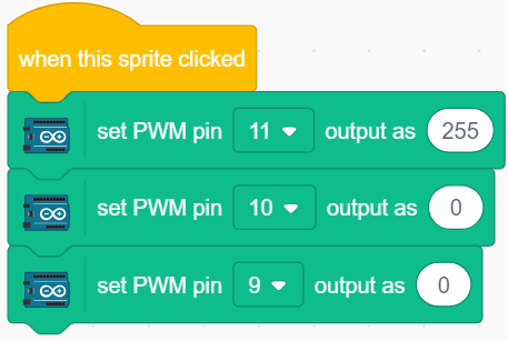

4. Ball3 sprite (red)
../_images/4_red.png

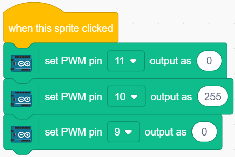

5. Ball4 sprite (green)
../_images/4_green.png

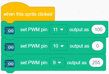

6. Ball5 sprite (purple)
../_images/4_purple.png
