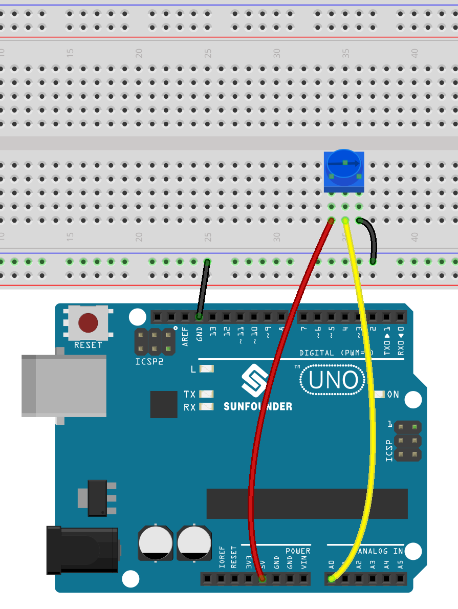

The potentiometer is a resistive element with 3 terminals, the 2 side pins are connected to 5V and GND, and the middle pin is connected to A0. After the conversion by the ADC converter of the Arduino board, the value range is 0-1023.

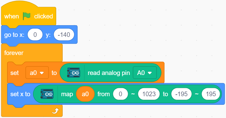

  • Now script the Paddle sprite to set its initial position to (0, -140) when the green flag is clicked, and read the value of A0 (potentiometer) into the variable a0. Since the Paddle sprite moves from left to right on the stage at x-coordinates -195~195, you need to use the [map] block to map the variable a0 range 0~1023 to -195~195.
../_images/17_padd2.png
  • Now you can rotate the potentiometer to see if the Paddle can move left and right on the stage.

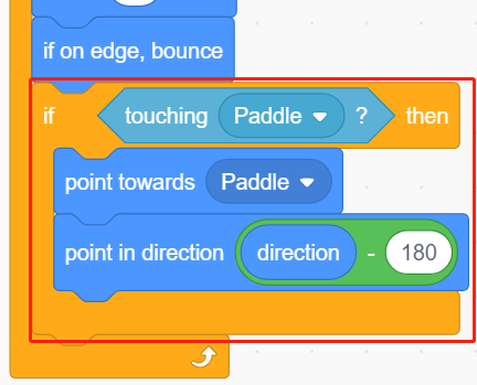

  • When the Ball sprite touches the Paddle sprite, do a reflection. The easy way to do this is to let the angle be directly inverted, but then you’ll find that the path of the ball is completely fixed, which is too boring. Therefore, we use the center of the two sprites to calculate and make the ball bounce in the opposite direction of the center of the baffle.
../_images/17_ball4.png ../_images/17_ball6.png

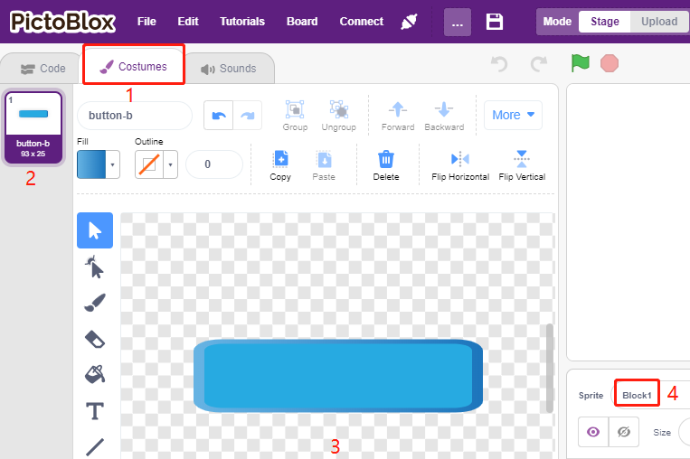

The Block1 sprite is not available in the PictoBlox library, you need to draw it yourself or modify it with an existing sprite. Here we are going to modify it with the Button3 sprite.
  • After adding the Button3 sprite, go to the Costumes page. Now delete button-a first, then reduce both the width and height of button-b, and change the sprite name to Block1, as shown in the following image.
  • For the width of Block1, you can probably simulate it on the screen to see if you can put down 8 in a row, if not, then reduce the width appropriately.
  • In the process of shrinking the Block1 sprite, you need to keep the center point in the middle of the sprite.
../_images/17_bri2.png

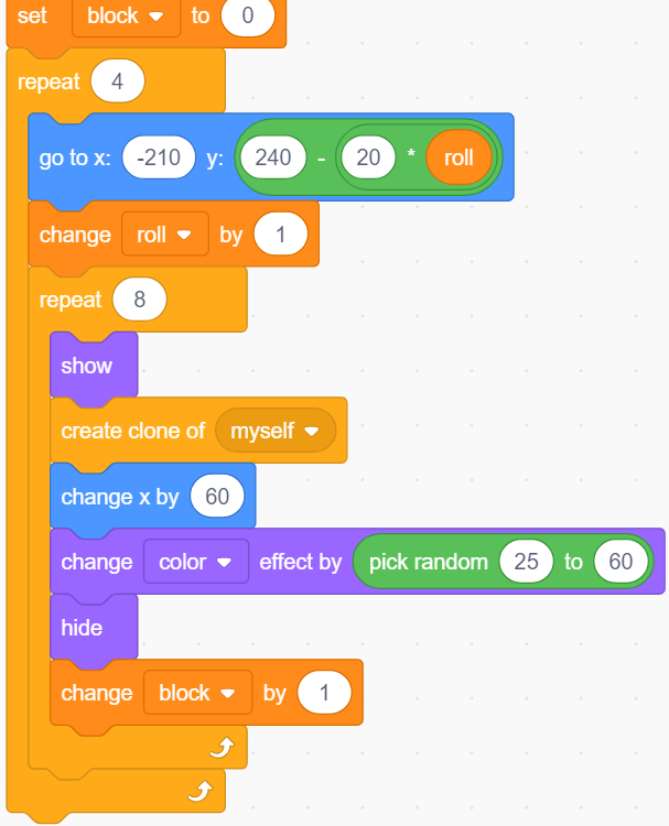

  • We need to make a clone of the Block1 sprite, so that it displays from left to right, top to bottom, one by one, 4x8 in total, with random colors.
../_images/17_bri4.png
  • After the script is written, click on the green flag and look at the display on the stage, if it is too compact or too small, you can change the size.

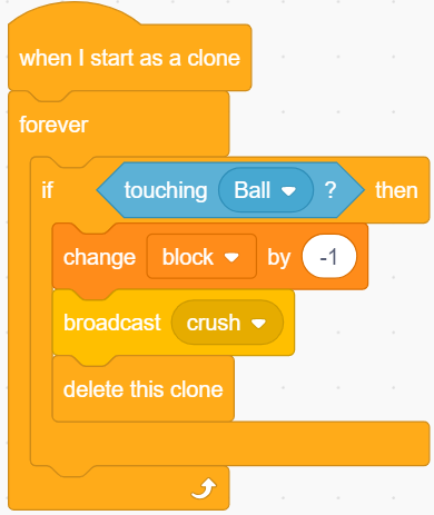

  • Now write the trigger event. If the cloned Block1 sprite touches the Ball sprite, delete the clone and broadcast the message crush.
../_images/17_bri6.png
