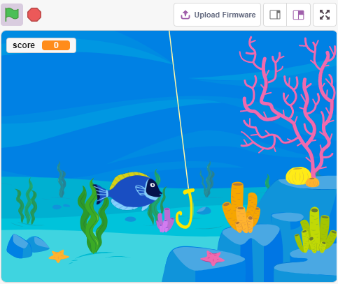

We need to select an Underwater backdrop first, then add a Fish sprite and let it swim back and forth on the stage. Then draw a Fishhook sprite and control it by a button to start fishing. When the Fish sprite touches the Fishhook sprite in the hooked state (turns red), it will be hooked.

The Fishhook sprite usually stays underwater in the yellow state; when the button is pressed, it is in the fishing state (red) and moves above the stage.

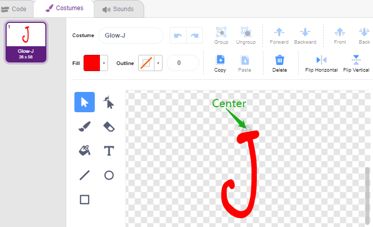

  • Now go to the Costumes page of the Glow-J sprite, select Cyan’s fill in the screen and remove it. Then change the J color to red and also reduce its width. The most important point to note is that you need to have the top of it just at the center point.
../_images/18_hook1.png

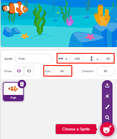

  • Now add the fish sprite and adjust its size and position.
../_images/18_fish1.png

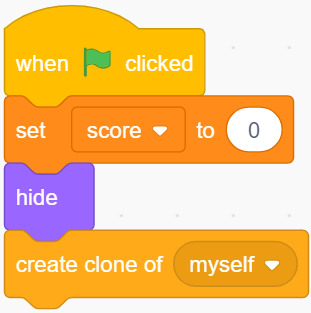

  • Create a variable score to store the number of fish caught, hide this sprite and clone it.
../_images/18_fish2.png

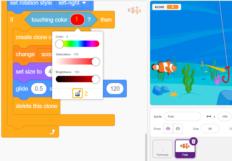

  • The fish sprite (of the clone) will not react when it passes the Fishhook sprite; when it touches the Fishhook sprite in the fishing state (turns red), it will be caught, at which point the score (variable score) +1, and it will also show a score animation (shrinks 40%, quickly moves to the position of the scoreboard and disappears). At the same time, a new fish is created (a new fish sprite clone) and the game continues.
You need to click on the color area in the [Touch color] block, and then select the eyedropper tool to pick up the red color of the Fishhook sprite on the stage. If you choose a color arbitrarily, this [Touch color] block will not work.
