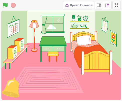

1. Add a Backdrop
Click the Choose a Backdrop button in the lower right corner.
../_images/7_backdrop.png
Choose Bedroom 1.
../_images/7_bedroom2.png
2. Select the sprite
Delete the default sprite, click the Choose a Sprite button in the lower right corner of the sprite area, enter bell in the search box, and then click to add it.
../_images/7_sprite.png
Then select the bell sprite on the stage and move it to the right position.
../_images/7_doorbell.png

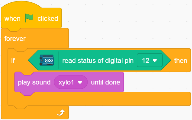

3. Press the button and the bell makes a sound
Use [if then] to make a conditional statement that when the value of the pin12 read is equal to 1 (the key is pressed), the sound xylo1 will be played.
  • [read status of digital pin]: This block is from the Arduino Uno palette and used to read the value of a digital pin, the result is 0 or 1.
  • [if then]: This block is a control block and from Control palette. If its boolean condition is true, the blocks held inside it will run, and then the script involved will continue. If the condition is false, the scripts inside the block will be ignored. The condition is only checked once; if the condition turns to false while the script inside the block is running, it will keep running until it has finished.
  • [play sound until done]: from the Sound palette, used to play specific sounds.
../_images/7_bell.png
