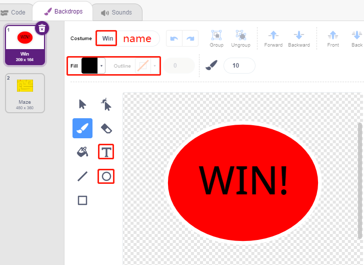

2. Draw a backdrop
Now it’s time to simply draw a backdrop with the WIN! character appearing on it.
First click on the backdrop thumbnail to go to the Backdrops page and click on the blank backdrop1.
../_images/14_paint_back.png
Now start drawing, you can refer to the picture below to draw, or you can draw a backdrop on your own, as long as the expression is winning.
  • Using the Circle tool, draw an ellipse with the color set to red and no outline.
  • Then use the Text tool, write the character "WIN!", set the character color to black, and adjust the size and position of the character.
  • Name the backdrop as Win.
../_images/14_win.png

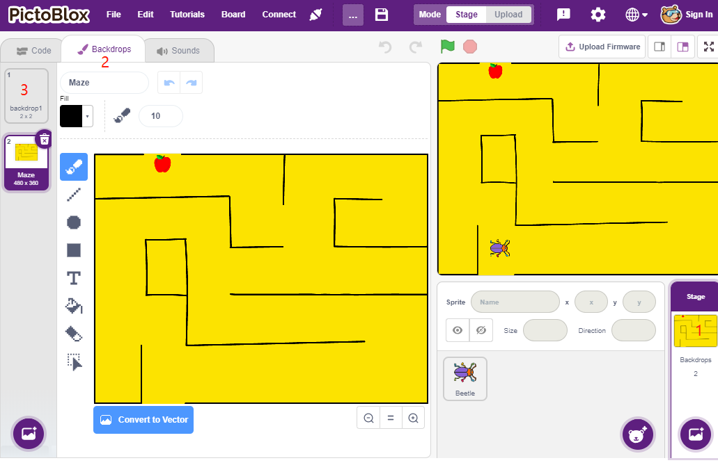

3. Scripting for the backdrop
The backdrop needs to be switched to Maze every time the game starts.
../_images/14_switchback.png

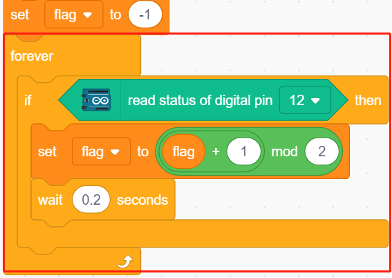

Next, in the [forever] block, four [if] blocks are used to determine various possible scenarios.
  • If the key is 1 (pressed), use the [mod] block to toggle the value of the variable flag between 0 and 1 (alternating between 0 for this press and 1 for the next press).

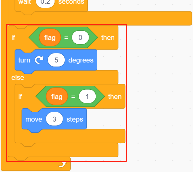

  • If flag=0 (this key press), let the Beetle sprite turn clockwise. Then determine if flag is equal to 1 (key pressed again), the Beetle sprite moves forward. Otherwise, it keeps turning clockwise.

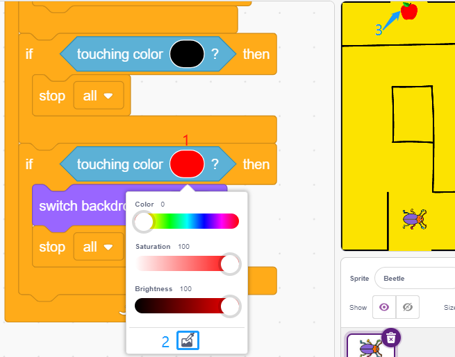

  • If the Beetle sprite touches black (the black line on the Maze backdrop), the game ends and the script stops running.
You need to click on the color area in the [Touch color] block, and then select the eyedropper tool to pick up the color of the black line on the stage. If you choose a black arbitrarily, this [Touch color] block will not work.
../_images/14_bee5.png
  • If Beetle touches red (Also use the straw tool to pick up the red color of the apple), the backdrop will be switched to Win, which means the game succeeds and stops the script from running.
