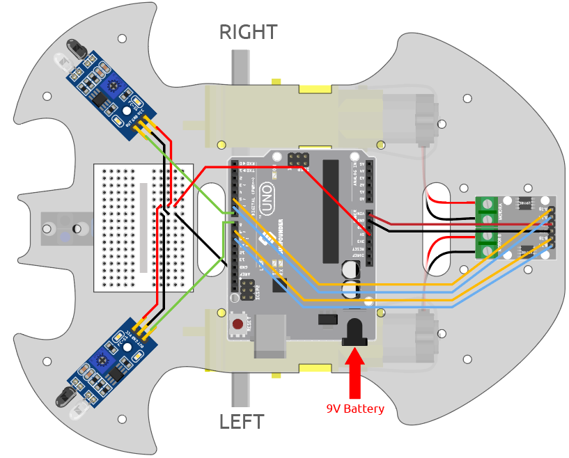

Build the Circuit
The obstacle avoidance module is a distance-adjustable infrared proximity sensor whose output is normally high and low when an obstacle is detected.
Now build the circuit according to the diagram below.
Left IR Module
R3 Board
OUT
8
GND
GND
VCC
5V
Right IR Module
R3 Board
OUT
7
GND
GND
VCC
5V
../../_images/car_51.png

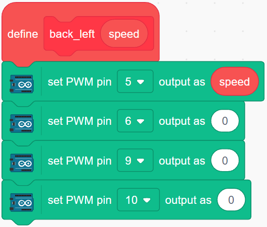

1. The car goes backward to the left
When the right motor is turning counterclockwise and the left motor is not turning, the car will go backward to the left.

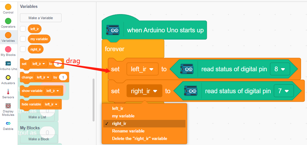

4. Read the values of the 2 IR modules
Click Make a variable in the Variables palette.
../../_images/5_avoid4.png
Enter the variable name and click OK to create a new variable.
../../_images/5_avoid5.png
Read the values of the left and right IR obstacle avoidance modules and store them in the 2 new variables.
../../_images/5_avoid6.png

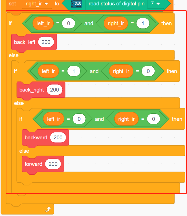

5. obstacle avoidance
  • When the left IR module is 0 (obstacle detected) and the right IR module is 1, let the car back up to the left.
  • When the right IR module is 0 (obstacle detected), let the car go back up to the right.
  • If 2 IR modules detect the obstacle at the same time, the car will go backward.
  • Otherwise the car will keep going forward.
../../_images/5_avoid7.png
