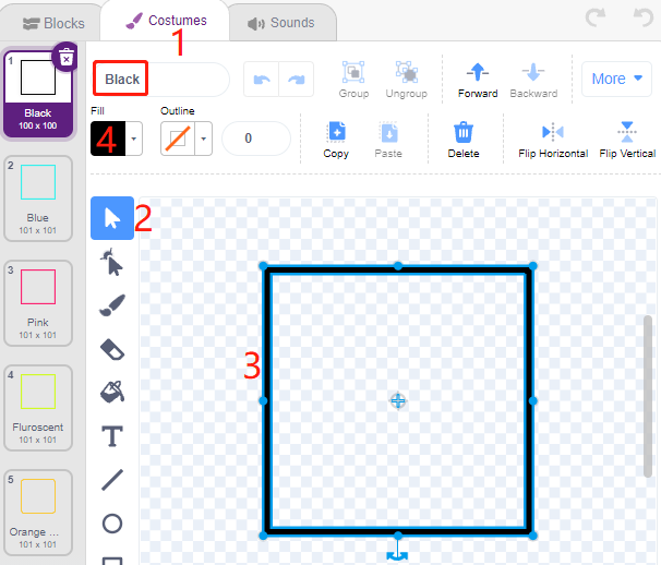

Go to the Square Box sprite’s Costumes page and set the black and white costumes.
  • Click the selection tool
  • Select the rectangle on the canvas
  • Select the fill color as black
  • and name the costume Black
../_images/22_heart2.png
Select the second costume, set the fill color to white, name it White, and delete the rest of the costume.

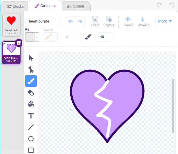

On the Costumes page, adjust the heart purple costume so that it appears to be broken.
../_images/22_heart6.png

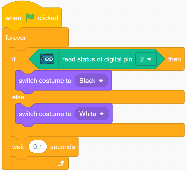

4. Scripting for Square Box sprite
Go back to the Blocks page and script Square Box sprite.
  • So when the value of the digital pin 2 (Line Following module) is 1 (black line detected), then switch the costume to Black.
  • Otherwise toggle the costume to White.
../_images/22_heart4.png

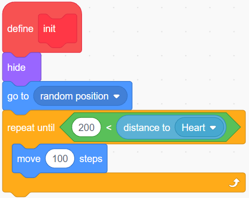

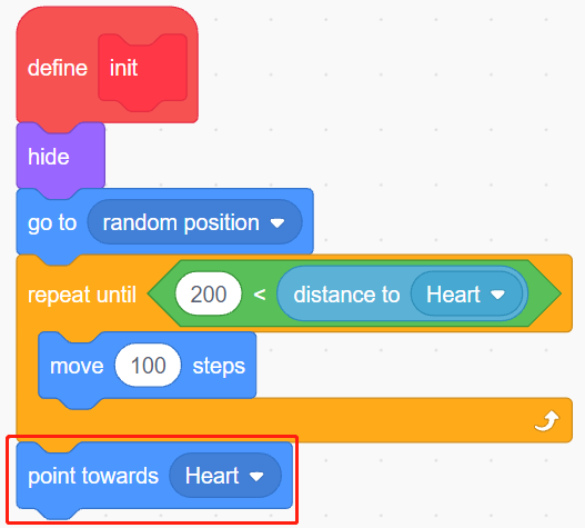

Create an [init] block to initialize the Arrow1 sprite’s position, orientation and color.
It appears at a random location, and if the distance between it and the Heart sprite is less than 200, it moves outward until the distance is greater than 200.
../_images/22_heart11.png
Set its direction to face the Heart sprite.

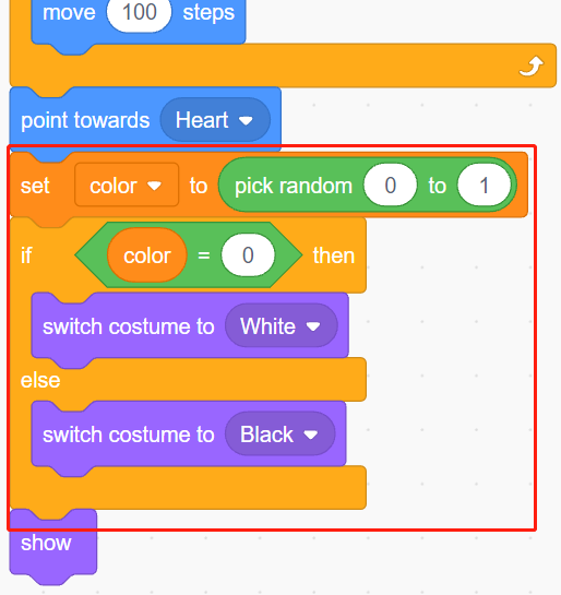

Make its color alternate randomly between black/white.
  • Variable color is 0, toggle costume to White.
  • Variable color is 1, toggles the outfit to Black.
../_images/22_heart14.png

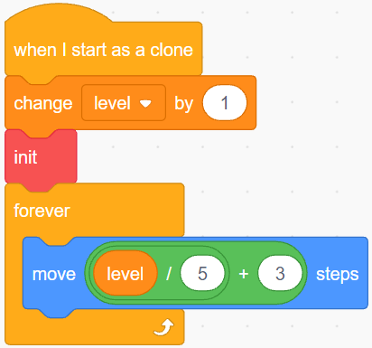

Now let it start moving, it will move faster as the value of the variable level increases.
../_images/22_heart13.png

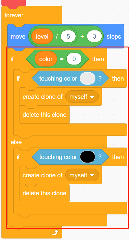

Now set its collision effect with the Square Box sprite.
  • If the Arrow1 sprite and the Square Box sprite have the same color (which will be modified according to the value of the Line Track module), either black or white, a new clone is created and the game continues.
  • If their colors do not match, the Arrow1 sprite continues to move and the game ends when it hits the Heart sprite.
../_images/22_heart15.png
The two [touch color()] blocks need to pick up the black/white costumes of Square Box separately.
