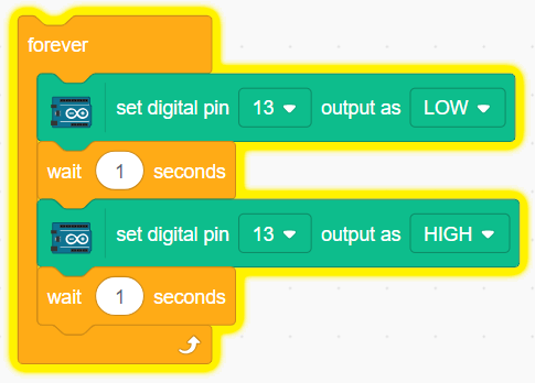

In order to see the effect of continuous blinking LED, you need to use the [Wait 1 seconds] and [forever] blocks in the Control palette. Click on these blocks after writing, there is a yellow halo means it is running.
  • [Wait 1 seconds]: from the Control palette, used to set the time interval between 2 blocks.
  • [forever]: from the Control palette, allows the script to keep running unless manually paused.
../../_images/1_more.png

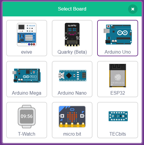

For example, choose Arduino Uno.
../../_images/1_choose_uno.png

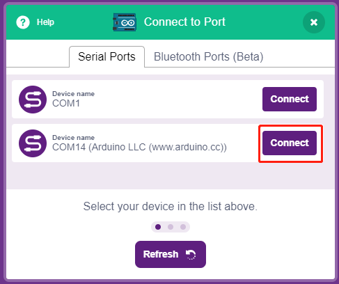

A connection window will then pop up for you to select the port to connect to, and return to the home page when the connection is complete. If you break the connection during use, you can also click Connect to reconnect.
../../_images/1_connect.png

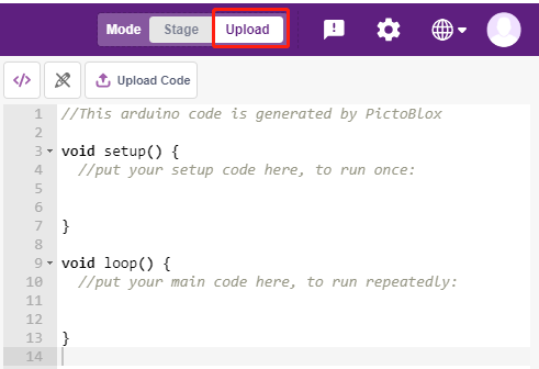

After selecting Upload mode, the stage will switch to the original Arduino code area.
../../_images/1_upload.png

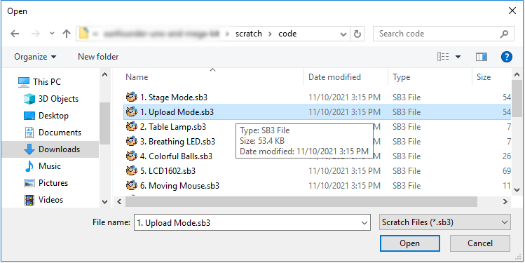

Choose Open from Computer.
../../_images/0_dic.png
Then go to the path of 3in1-kit\scratch_project\code, and open 1. Upload Mode.sb3. Please ensure that you have downloaded the required code from github.

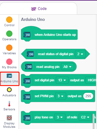

Click on the Arduino Uno palette.
../../_images/1_upload_uno.png
Drag [when Arduino Uno starts up] to the script area, which is required for every script.

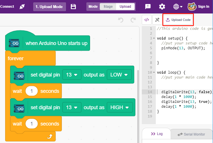

At this point you will see the Arduino code appear on the right side, if you want to edit this code, then you can turn Edit mode on.
../../_images/1_upload1.png

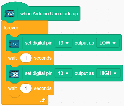

  • [forever]: from the Control palette, allows the script to keep running unless the power is off.
../../_images/1_upload_more.png
Finally, click the Upload Code button.
../../_images/1_upload_code.png
