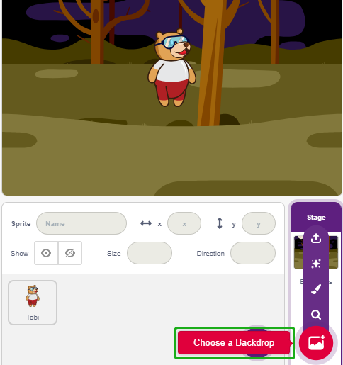

Woods backdrop added via the Choose a Backdrop button.
../_images/19_dragon01.png

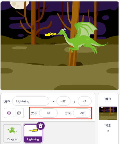

  • Add a Lightning sprite as the fire blown by the Dragon sprite. You need to rotate it 90° clockwise in the Costumes page, this is to make the Lightning sprite move in the right direction.
When adjusting the Lightning sprite’s costume, you may move it off-center, which must be avoided! The center point must be right in the middle of the sprite!

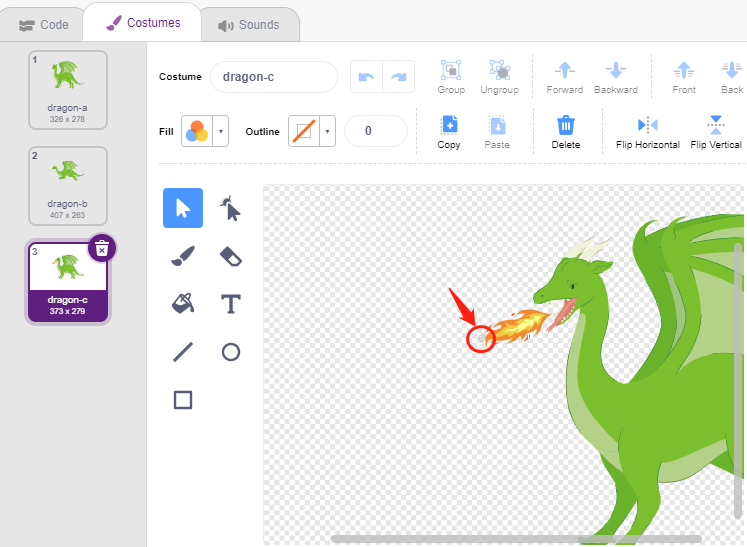

  • Then adjust the dragon-c costume of the Dragon sprite so that its center point should be at the tail of the fire. This will make the positions of the Dragon sprite and the Lightning sprite correct, and prevent Lightning from launching from the dragon’s feet.

  • Adjust the size and orientation of the Lightning sprite to make the image look more harmonious.

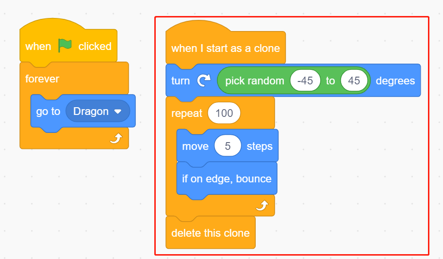

  • Now script the Lightning sprite. This is easy, just have it follow the Dragon sprite all the time. At this point, click on the green flag and you will see Dragon moving around with lightning in its mouth.
../_images/19_lightning4.png

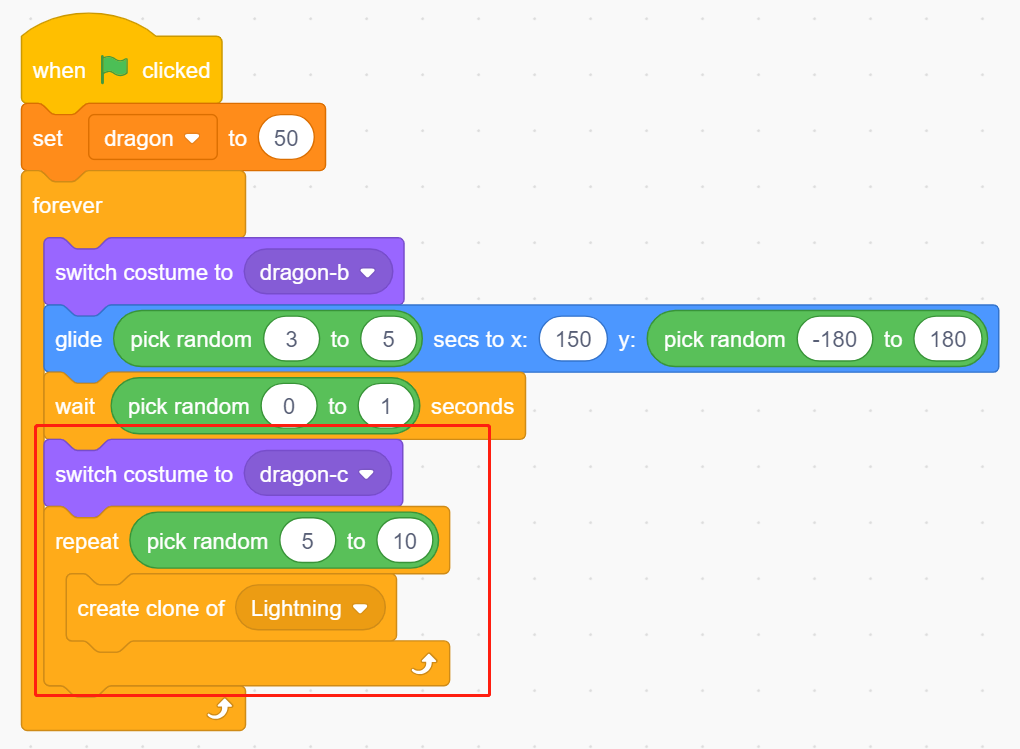

  • Back to the Dragon sprite, now have it blow out fire, being careful not to let the fire in its mouth shoot out, but to create a clone for the Lightning sprite.

  • Click on the Lightning sprite and let the Lightning clone shoot out at a random angle, it will bounce off the wall and disappear after a certain amount of time.
../_images/19_lightning5.png

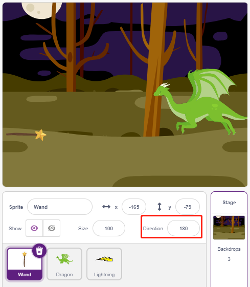

2.Wand
  • Create a Wand sprite and rotate its direction to 180 to point to the right.
../_images/19_wand1.png

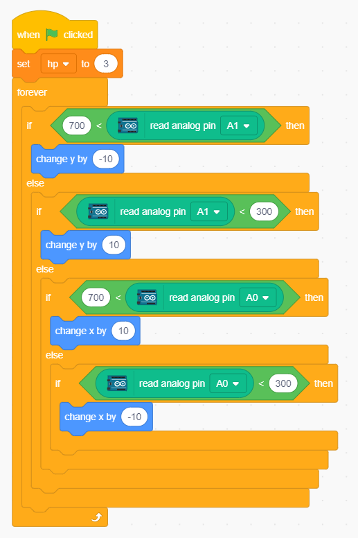

  • Now create a variable hp to record its life value, initially set to 3. Then read the Joystick’s value, which is used to control the wand’s movement.
../_images/19_wand2.png

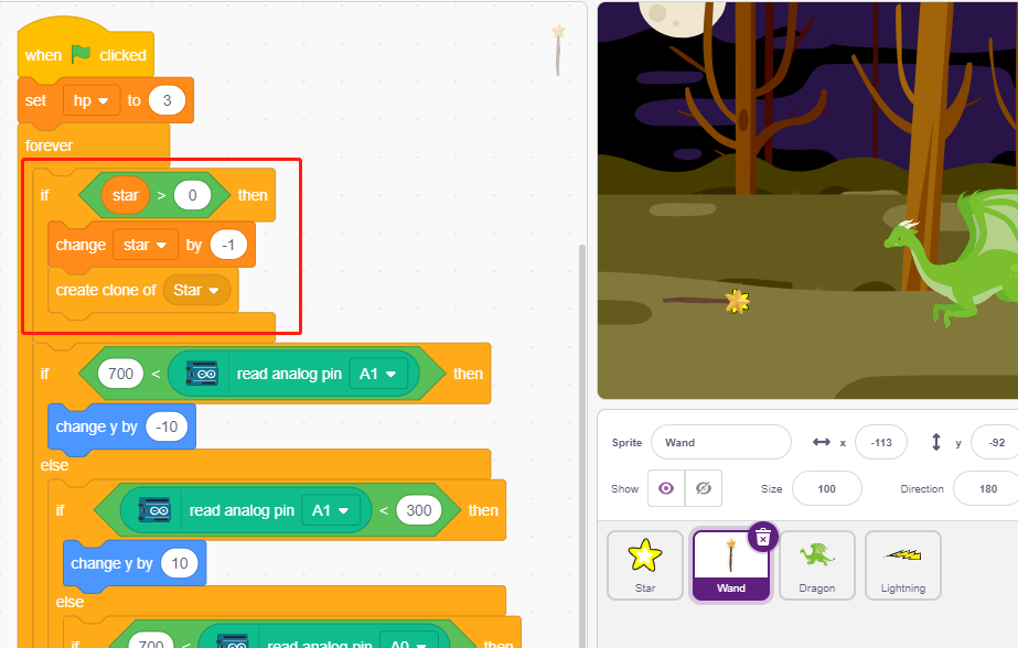

  • Make the Wand sprite shoot stars automatically. The Wand sprite shoots stars the same way the dragon blows fire – by creating clones.
../_images/19_wand3.png

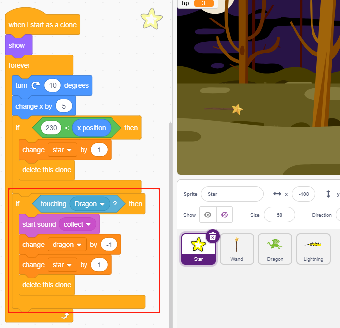

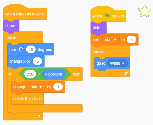

  • Go back to the Star sprite and script its clone to spin and shoot to the right, disappear after going beyond the stage and restoring the number of stars. Same as Lightning sprite, hide the body and show the clone.
../_images/19_star3.png

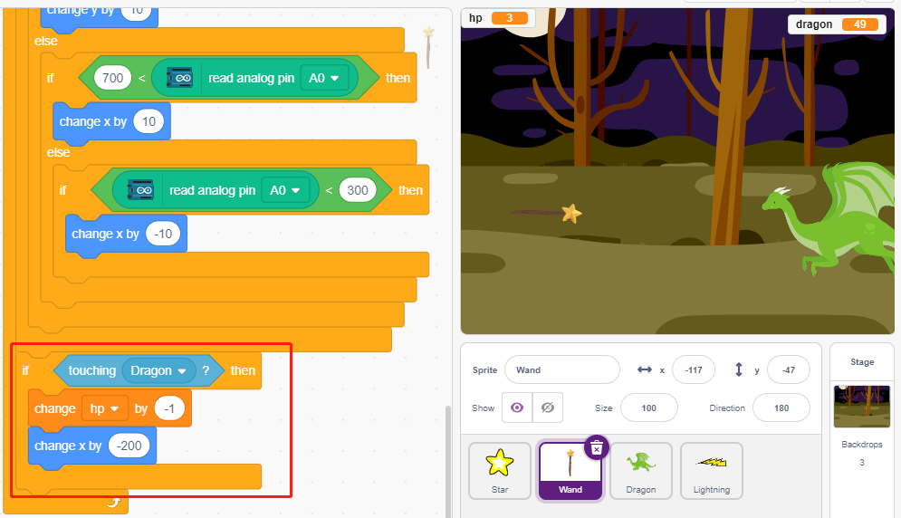

  • If the Wand hits the Dragon, it will be knocked back and lose life points.

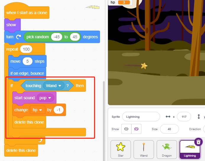

  • If Lightning (a Lightning sprite clone) hits the Wand sprite, it will make a pop sound and disappear, and the Wand will lose life points.

  • If a Star (clone of the Star sprite) hits the Dragon, it will emit a collect sound and disappear, while restoring the Star count, and the Dragon will lose life points.
../_images/19_star4.png

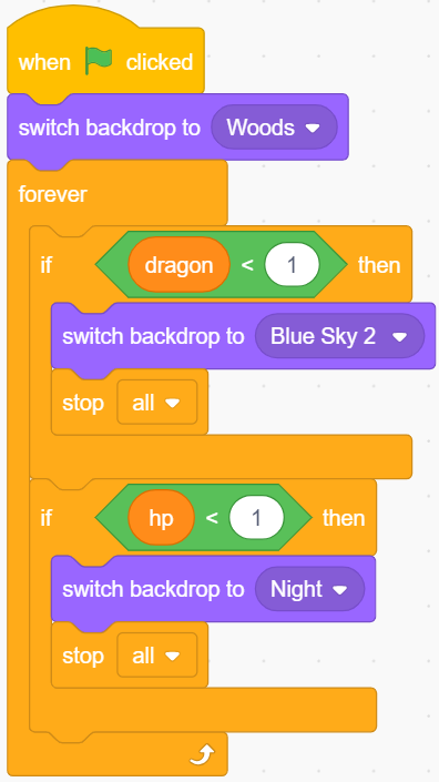

4. stage
The battle between the Wand and the Dragon will eventually be divided into winners and losers, which we represent with the stage.

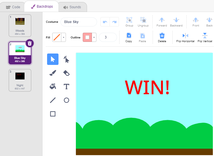

  • Add Blue Sky backgdrop, and write the character “WIN!” on it to represent that the dragon has been defeated and the dawn has come.
../_images/19_sky0.png
  • And modify the blank backdrop as follows, to represent that the game has failed and everything will be in darkness.
../_images/19_night.png
  • Now write a script to switch these backgdrops, when the green flag is clicked, switch to Woods backgdrop; if the dragon’s life point is less than 1 , then the game succeeds and switch the backdrop to Blue Sky; if the life value point of the Wand is less than 1, then switch to Night backdrop and the game fails.
