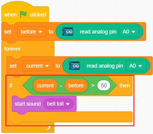

2. Read the value of A0
Create two variables before and current. When green flag is clicked, read the value of A0 and store it in variable before as a reference value. In [forever], read the value of A0 again, store it in the variable current.
../_images/10_reada0.png
3. Make a sound
When the value of current A0 is greater than the previous 50, which represents the current light intensity is greater than the threshold, then let the sprite make a sound.

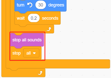

5. stop all
Stops the alarm when it has been ringing for a while.
../_images/10_stop.png
