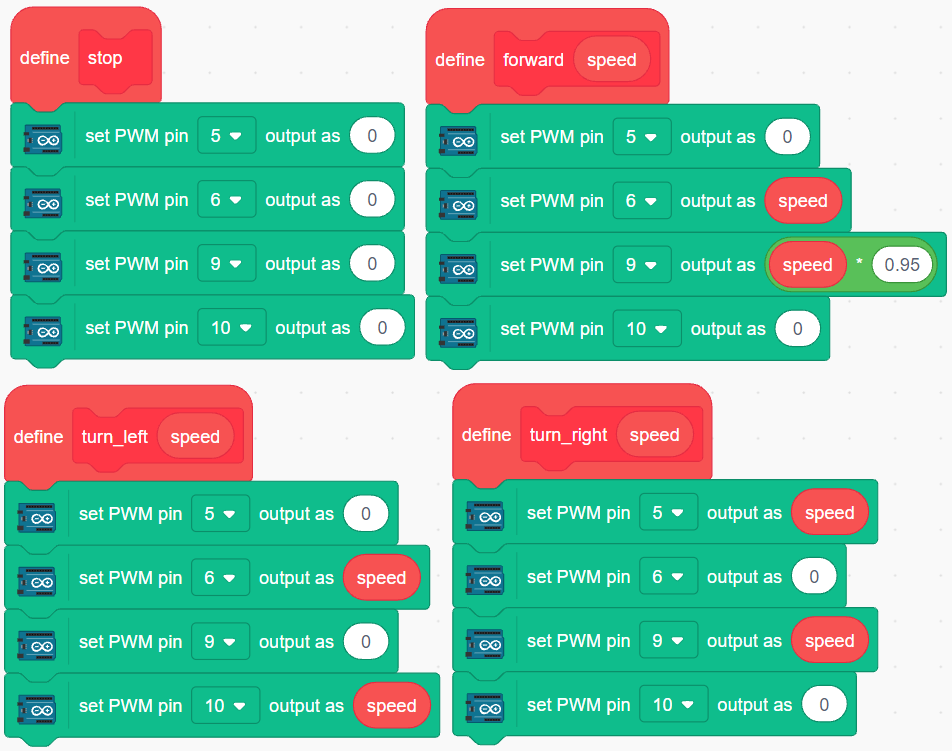

1. Create a block
Create blocks that allow the car to move forward, turn left, turn right and stop.
../../_images/6_follow2_1.png
