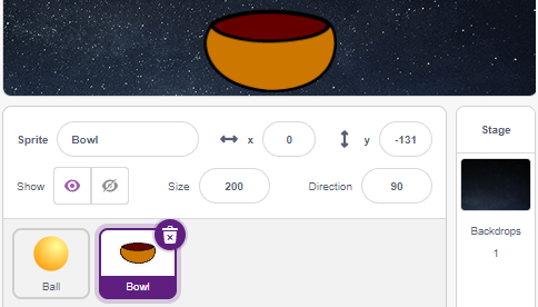

Move the Bowl sprite to the bottom center of the stage and enlarge its size.
../_images/18_ball3.png

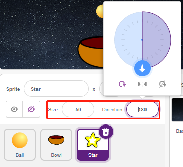

Set the size and direction of the Star sprite to 180 because we need it to fall down, or you can change it to another angle.
../_images/18_ball12.png

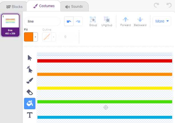

2. Draw a Line sprite
Add a Line sprite.
../_images/18_ball7.png

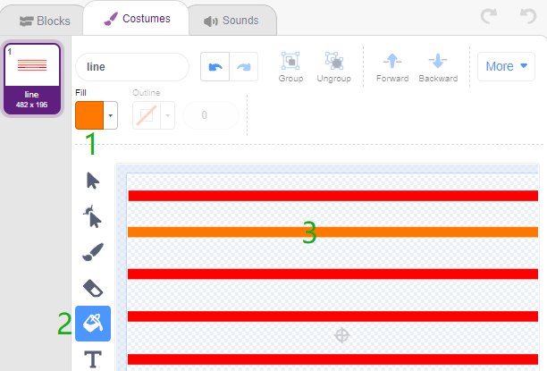

Go to the Costumes page of the Line sprite, reduce the width of the red line on the canvas slightly, then copy it 5 times and align the lines.
../_images/18_ball8.png
Now fill the lines with different colors. First choose a color you like, then click on the Fill tool and move the mouse over the line to fill it with color.
../_images/18_ball9.png
Follow the same method to change the color of the other lines.
../_images/18_ball10.png

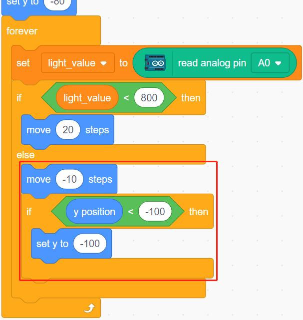

Otherwise, the Ball sprite will fall and limit its Y coordinate to a minimum of -100. This can be modified to make it look like it is falling on the Bowl sprite.
../_images/18_ball6.png

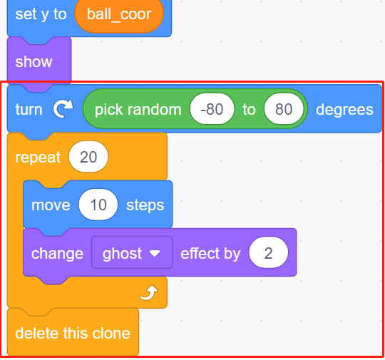

Create the effect of the Star sprite appearing, and adjust it as needed.
../_images/18_ball15.png
