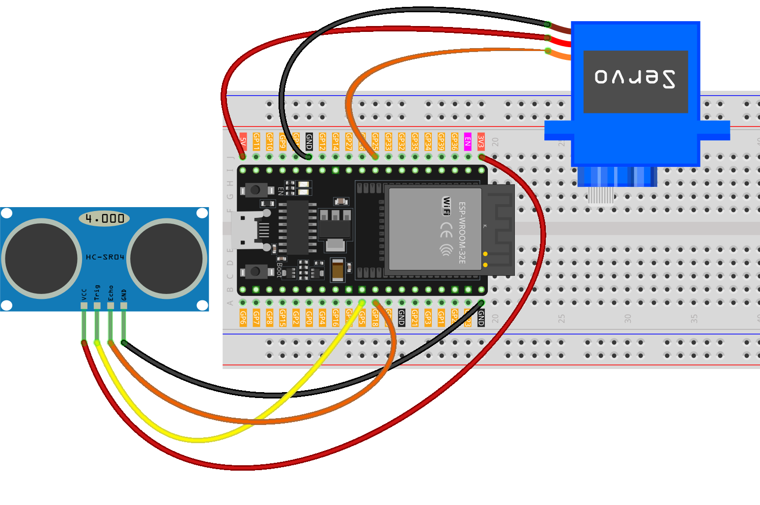

Wiring
../_images/trash_can_bb1.png
Common Connections:
  • Digital Servo Motor
    • GND: Connect to GND on the ESP32.
    • VCC: Connect to 5V on the ESP32.
    • Connect to GPIO25 on the ESP32.
  • Ultrasonic Sensor Module
    • Trig: Connect to GPIO5 on the ESP32.
    • Echo: Connect to GPIO18 on the ESP32.
    • VCC: Connect to 3.3V on the ESP32.
