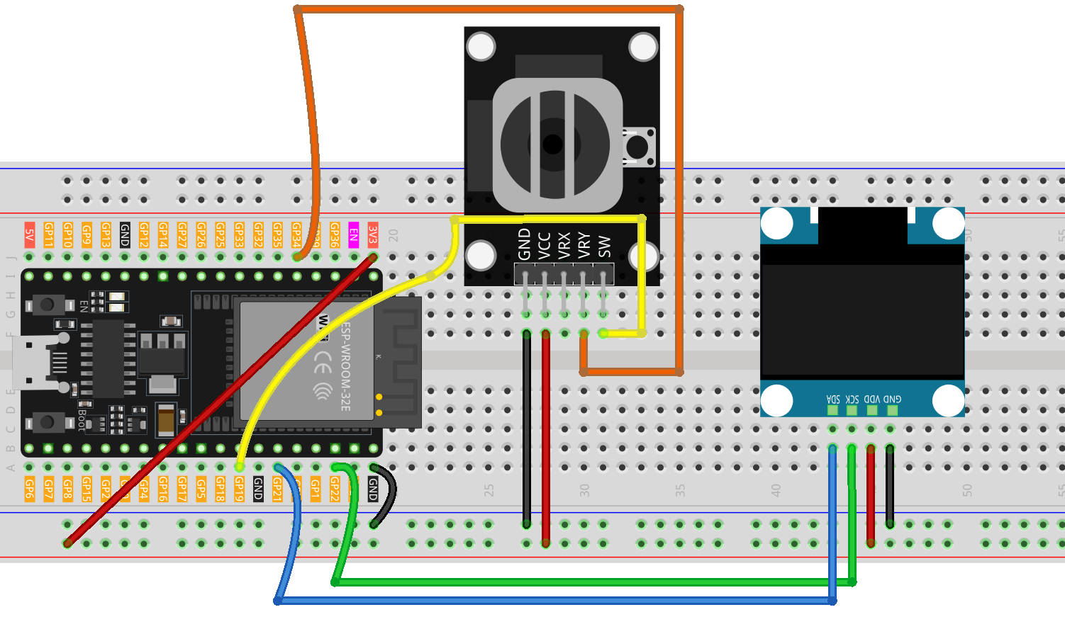

Wiring
../_images/Brick_Breaker_bb1.png
Common Connections:
  • Joystick Module
    • VRY: Connect to GPIO34 on the Arduino.
    • SW: Connect to GPIO19 on the Arduino.
    • VCC: Connect to breadboard’s red power bus.
  • OLED Display Module
    • SDA: Connect to GPIO21 on the Arduino.
    • SCK: Connect to GPIO22 on the Arduino.
