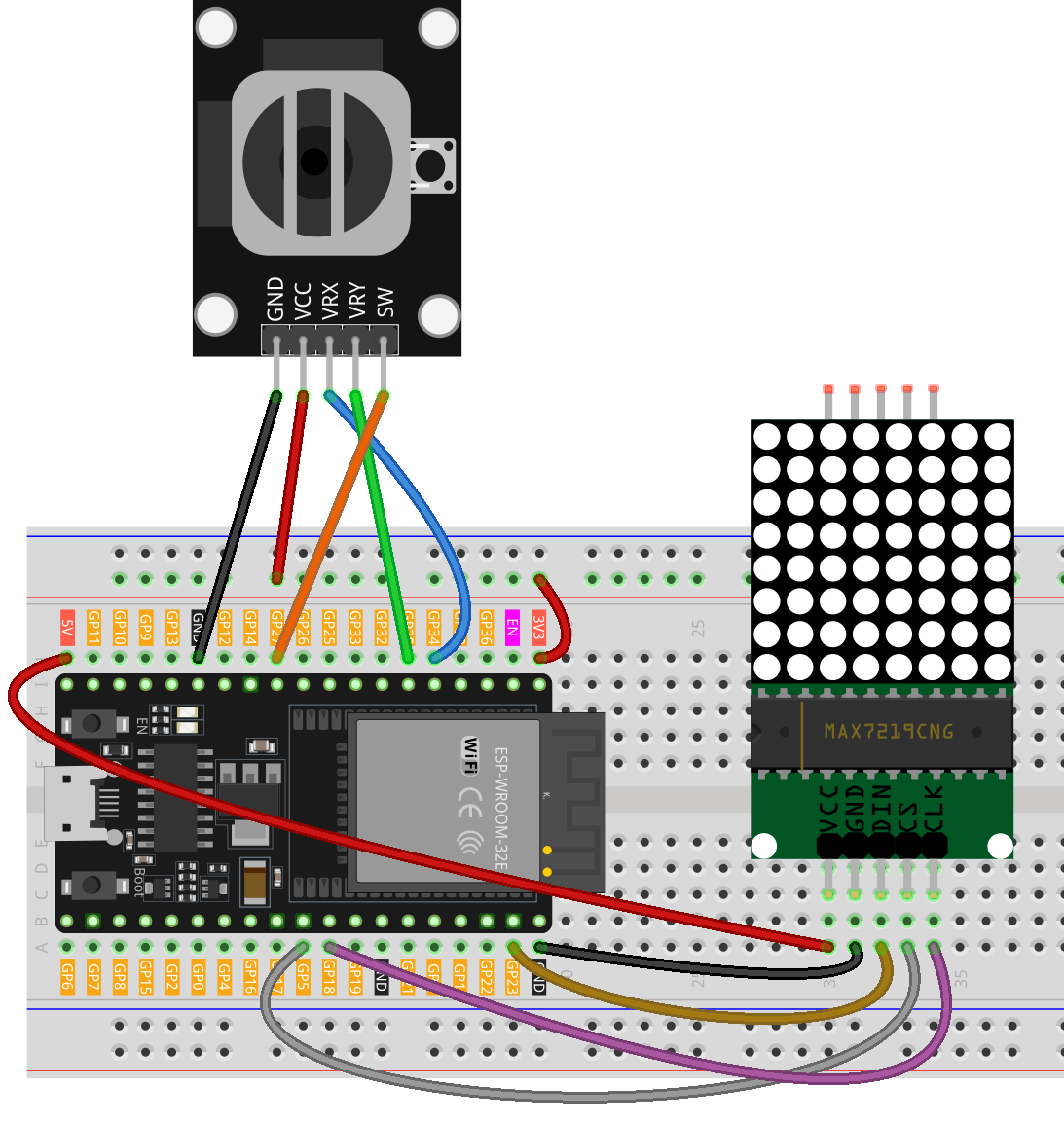

Wiring
../_images/Snake_Game_bb1.png
Common Connections:
  • MAX7219 Dot Matrix Module
    • CLK: Connect to GPIO18 on the ESP32.
    • CS: Connect to GPIO5 on the ESP32.
    • DIN: Connect to GPIO23 on the ESP32.
    • GND: Connect to GND on the ESP32.
    • VCC: Connect to 5V on the ESP32.
  • Joystick Module
    • SW: Connect to GPIO27 on the ESP32.
    • VRY: Connect to GPIO35 on the ESP32.
    • VRX: Connect to GPIO34 on the ESP32.
    • VCC: Connect to breadboard’s 3.3V red power bus.
