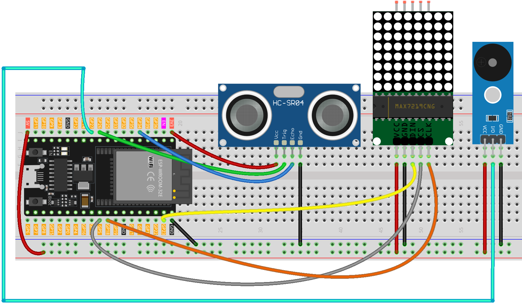

Wiring
../_images/Parking_Sensor_1.0_bb1.png
Common Connections:
  • Passive Buzzer Module
    • I/O: Connect to GPIO27 on the ESP32.
  • MAX7219 Dot Matrix Module
    • CLK: Connect to GPIO18 on the ESP32.
    • CS: Connect to GPIO5 on the ESP32.
    • DIN: Connect to GPIO18 on the ESP32.
  • Ultrasonic Sensor Module
    • Trig: Connect to GPIO26 on the ESP32.
    • Echo: Connect to GPIO34 on the ESP32.
    • GND: Connect to GND on the ESP32.
    • VCC: Connect to 3.3V on the ESP32.
