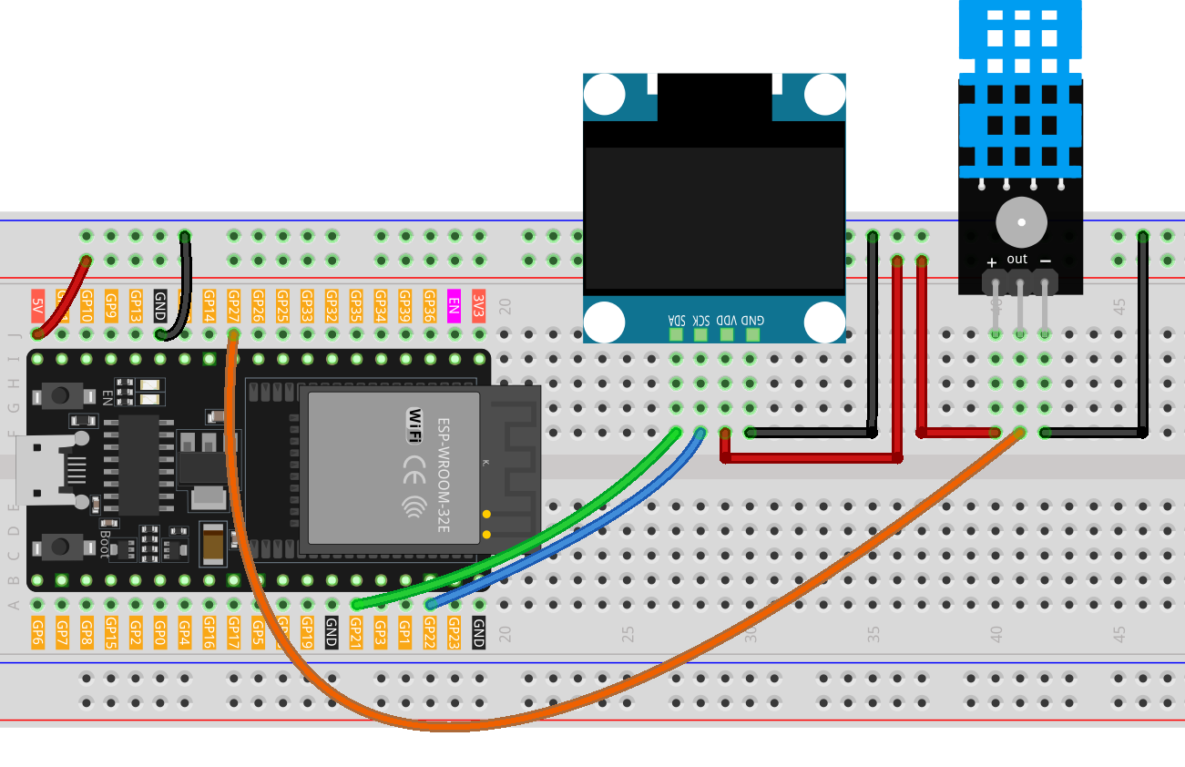

Wiring
../_images/TempHumid_Monitor_bb1.png
Common Connections:
  • DHT-11 Module
    • OUT: Connect to GPIO27 on the ESP32.
    • -:** Connect to breadboard’s negative power bus.
    • +: Connect to breadboard’s red power bus.
  • OLED Display Module
    • SDA: Connect to GPIO21 on the ESP32.
    • SCK: Connect to GPIO22 on the ESP32.
    • VCC: Connect to breadboard’s red power bus.
