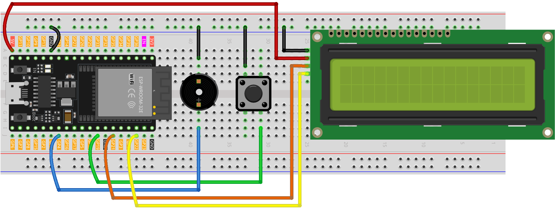

Wiring
../_images/Dino_Run_bb1.png
Common Connections:
  • I2C LCD 1602
    • SDA: Connect to GPIO21 on the ESP32.
    • SCL: Connect to GPIO22 on the ESP32.
    • VCC: Connect to 5V on the ESP32.
  • Passive Buzzer
    • +: Connect to GPIO4 on the ESP32.
    • -: Connect to breadboard’s negative power bus.
  • Button
    • Connect to breadboard’s negative power bus.
    • Connect to GPIO19 on the ESP32.
