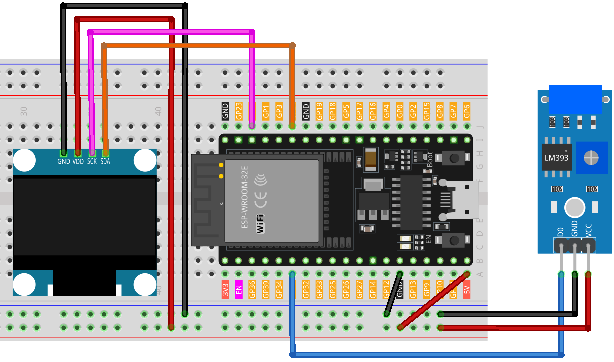

Wiring
../_images/Lesson_42_Digital_dice_esp32.png
Common Connections:
  • OLED Display Module
    • SDA: Connect to GPIO21 on the ESP32.
    • SCK: Connect to GPIO22 on the ESP32.
    • VCC: Connect to breadboard’s red power bus.
  • Vibration Switch Sensor Module
    • D0: Connect to GPIO35 on the ESP32.
