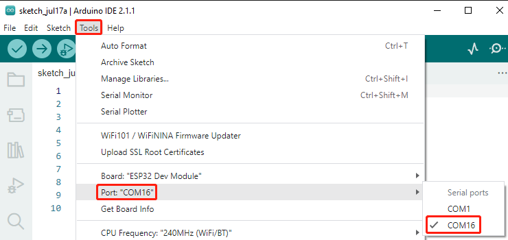

  2. If your ESP32 is connected to the computer, you can choose the correct port by clicking Tools -> Port.
    ../../_images/install_esp3261.png

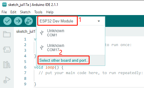

  3. In addition, Arduino 2.0 introduced a new way to quickly select the board and port. For ESP32, it is usually not recognized automatically, so you need to click on Select other board and port.
    ../../_images/install_esp3271.png

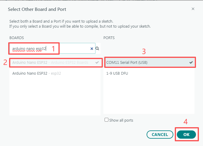

  4. In the search box, type Arduino Nano ESP32 and select it when it appears. Then, choose the correct port and click OK.
    ../../_images/select_board.png

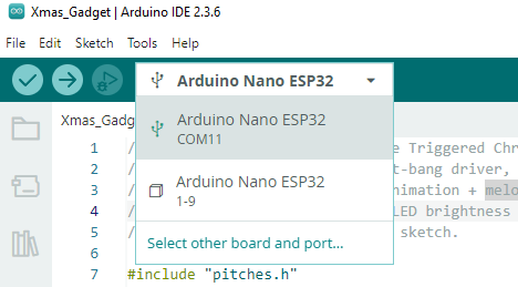

  5. Afterwards, you can select it through this quick access window. Note that during later use, it may happen that ESP32 is not available in the quick access window, and you will need to repeat the previous two steps.
    ../../_images/last_step_esp32.png
