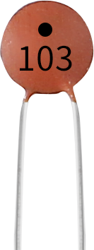

In this kit, ceramic capacitors and electrolytic capacitors are used.
There are 103 or 104 label on the ceramic capacitors, which represent the capacitance value, 103=10x10^3pF, 104=10x10^4pF
