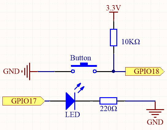

Diagramma Schematica
../_images/4.1.1_camera_schematic1.png

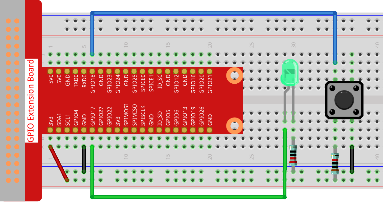

Procedure Sperimentali
../_images/4.1.1_camera_circuit1.png
