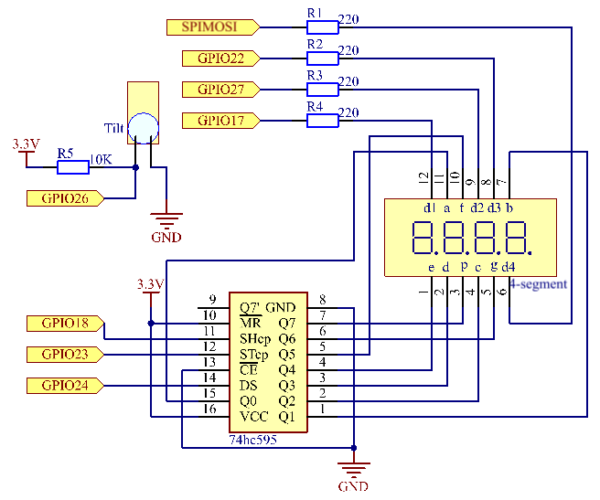

Schema del Circuito
Pin 19
Pin 16
Pin 18
GPIO26
Pin 37
25
26
../_images/4.1.18_game_10_second_schematic.png
