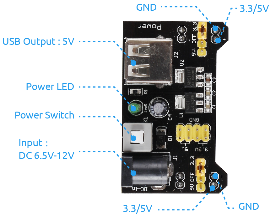

Power Supply Module
This breadboard power module provides 3.3V and 5V outputs and features a series diode for reverse polarity protection.
It accepts input voltages ranging from 6.5V to 12V and efficiently generates both 3.3V and 5V outputs.
This module is an essential tool for experimenters and prototypers working with electronic circuits on breadboards or perforated/veroboards, offering a reliable and convenient power supply solution.
- Features
Plug directly to MB102 Standard breadboard.
Input voltage: 6.5-12 V (DC) or 5V USB power supply.
Output voltage: 3.3V and 5V can switch over.
Maximum output current: <700 mA.
External Input voltage ON/OFF switch.
Independent control of upper and Lower Bread Board Power Rails. Can switch over to 0V, 3.3V, 5V using jumpers on any rail.
On-board two groups of 3.3V, 5V DC output plug pin, convenient external lead use.
USB device connector onboard for power output to external device.
Size: 5.3cm x 3.5cm.
