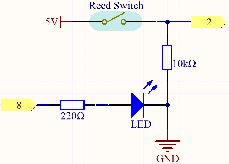

Schema
../_images/circuit_8.1_ifelse.png
