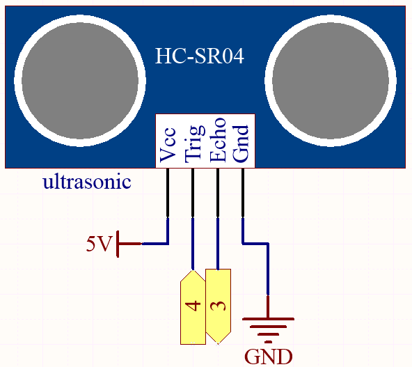

Schema
../_images/circuit_6.3_ultrasonic.png
