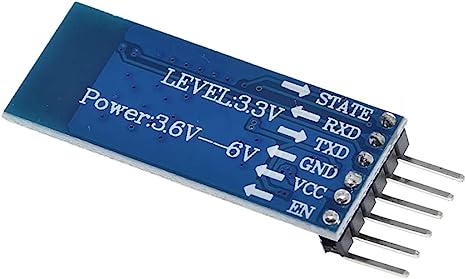

Pins of JDY-31 and their functions:
Pin |
Name |
Description |
1 |
STATE |
Connection status pin (not connected low level, output high level after connectio) |
2 |
RXD |
Receiver pin, this pin must connect to TX pin of next device. |
3 |
TXD |
Transmitter pin, this pin must connect to RX pin of next device. |
4 |
GND |
GND |
5 |
VCC |
Power Supply(1.8-3.6V, 3.3v recommended) |
6 |
EN |
enable or disable the module. When this pin is held high, the module is enabled and begins transmitting and receiving data. |
