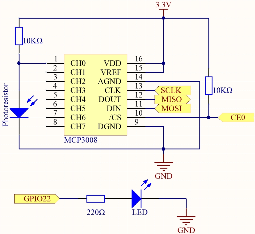

Schema elettrico
Nome T-Board
Fisico
WiringPi
pin24
pin19
SPIMISO
pin21
SPISCLK
pin23
pin15
../_images/schematic_2.2.1_photoresistor_mcp30081.png
