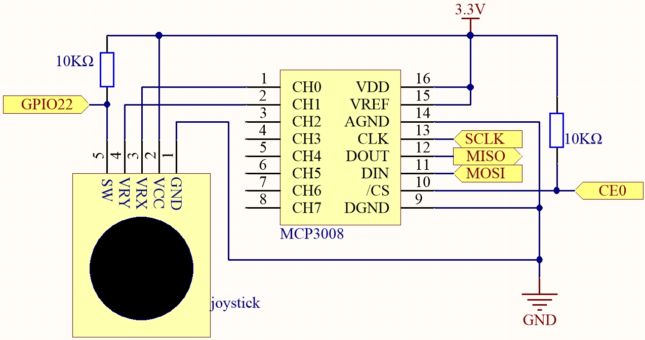

Schematic Diagram
When the data of joystick is read, there are some differents between axis: data of X and Y axis is analog, which need to use MCP3008 to convert the analog value to digital value. Data of Z axis is digital, so you can directly use the GPIO to read, or you can also use ADC to read.
T-Board Name
physical
WiringPi
SPICE0
pin24
10
8
SPIMOSI
pin19
12
10
SPIMISO
pin21
13
9
SPISCLK
pin23
14
11
GPIO22
pin15
22
../_images/schematic_2.1.9_joystick_mcp30081.png

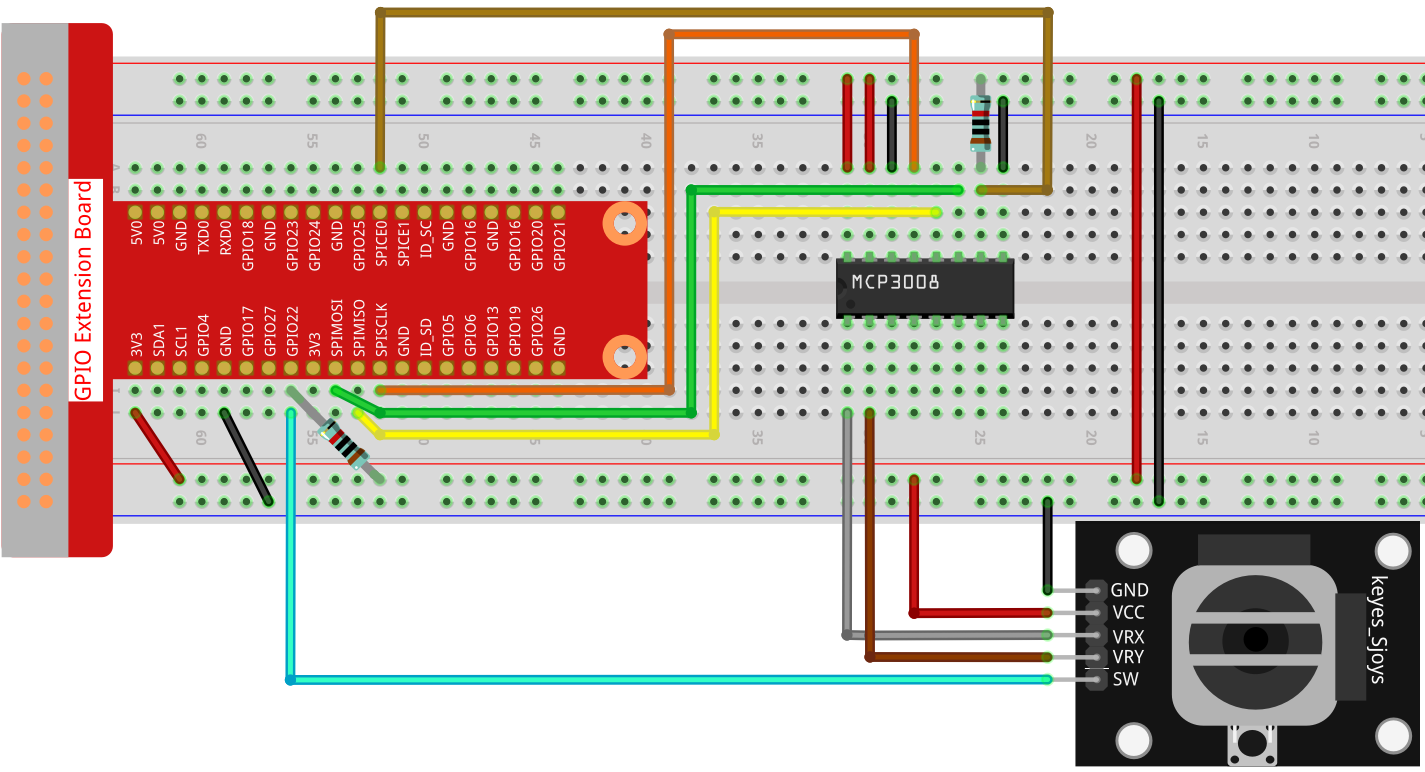

Step 1: Build the circuit.
../_images/july24_2.1.9_joystick_mcp30081.png

Step 4: Run.
sudo python3 2.1.6-2_Joystick_zero.py
After the code runs, turn the Joystick, then the corresponding values of x, y, Btn are displayed on screen.
