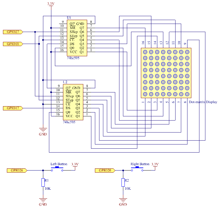

Schema Elettrico
T-Board Name
physical
wiringPi
GPIO17
Pin 11
0
17
GPIO18
Pin 12
18
GPIO27
Pin 13
27
GPIO20
Pin 38
28
20
GPIO26
Pin 37
25
26
../_images/3.1.14_game_not_not_schematic.png
