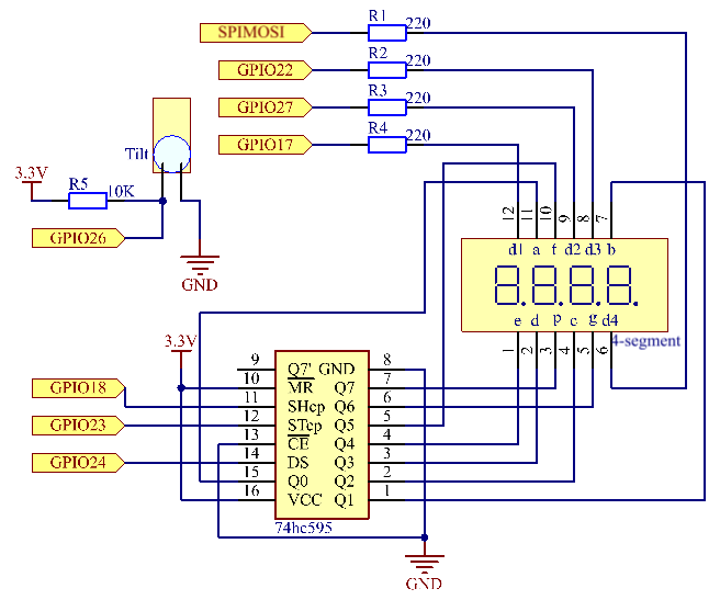

Schema Elettrico
T-Board Name
physical
wiringPi
GPIO17
Pin 11
0
17
GPIO27
Pin 13
27
GPIO22
Pin 15
22
SPIMOSI
Pin 19
12
10
GPIO18
Pin 12
18
GPIO23
Pin 16
23
GPIO24
Pin 18
24
GPIO26
Pin 37
25
26
../_images/4.1.18_game_10_second_schematic.png

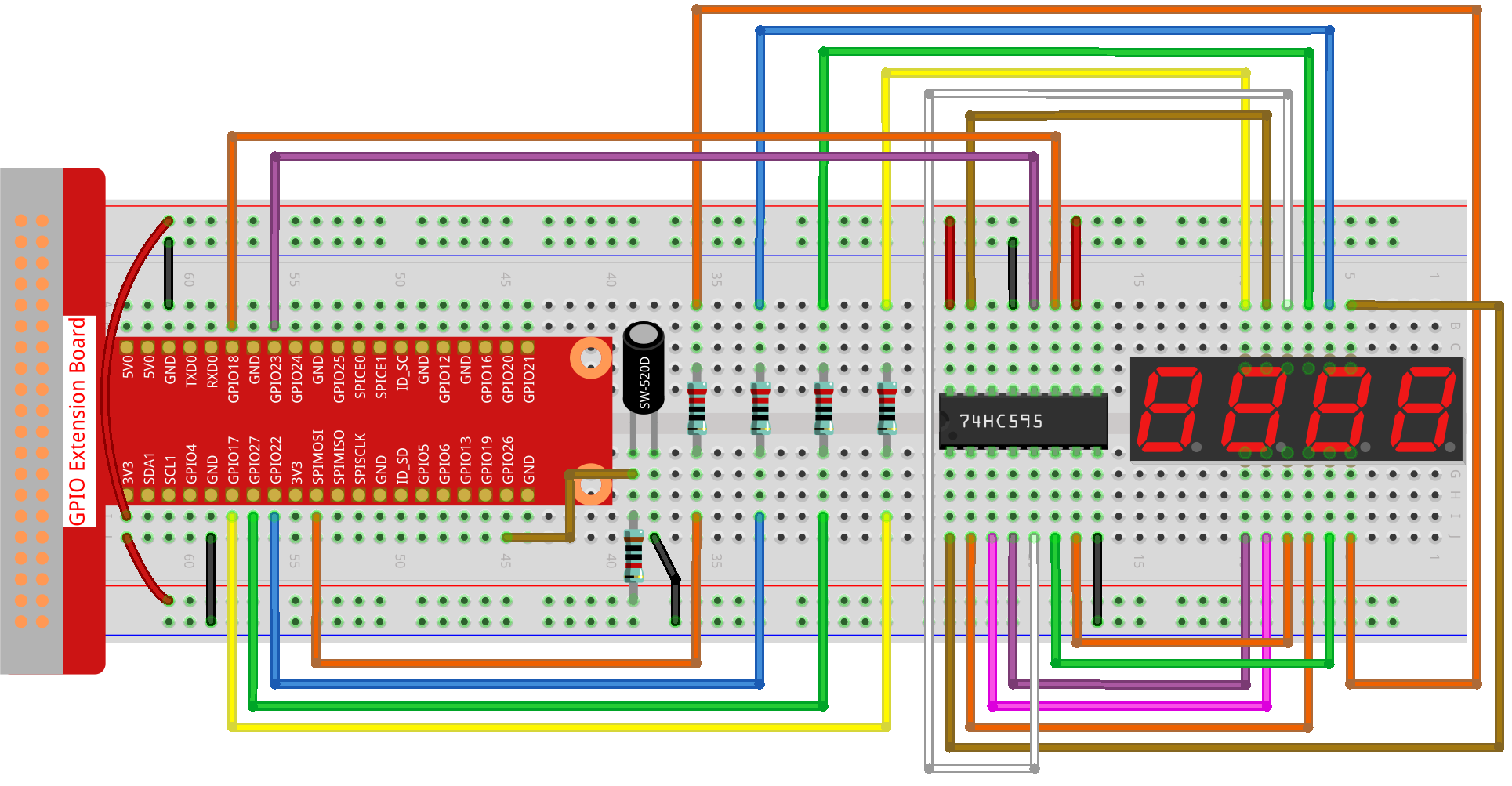

Step 1: Assembla il circuito.
../_images/4.1.18_game_10_second_circuit.png
