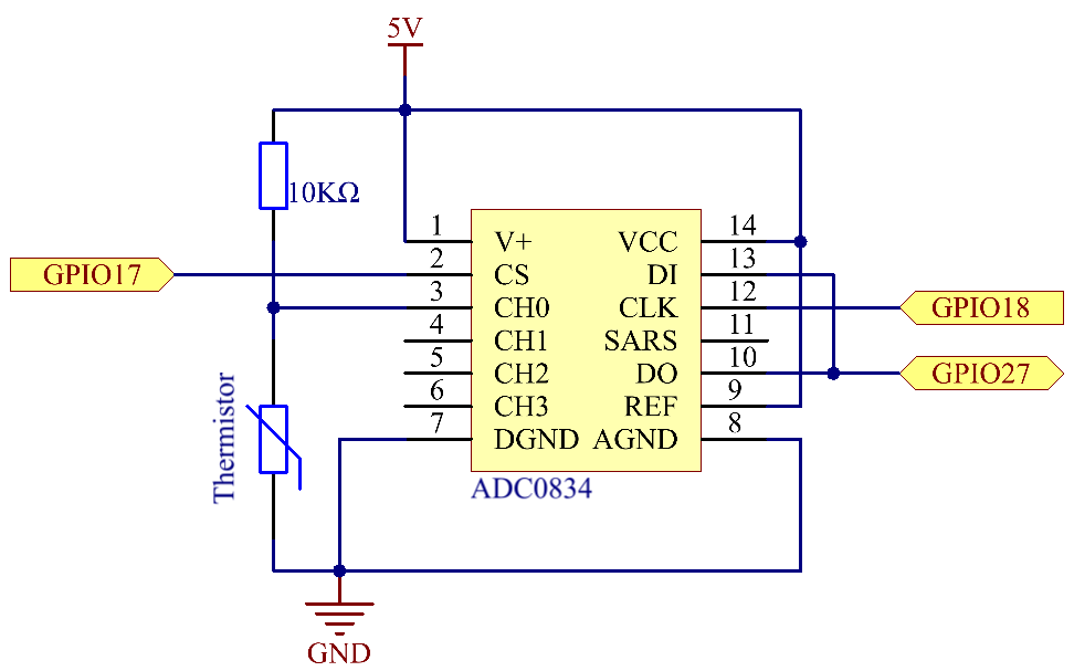

Schema a Blocchi
../_images/image323.png ../_images/image324.png

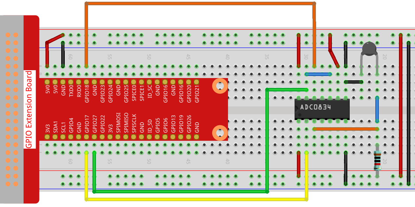

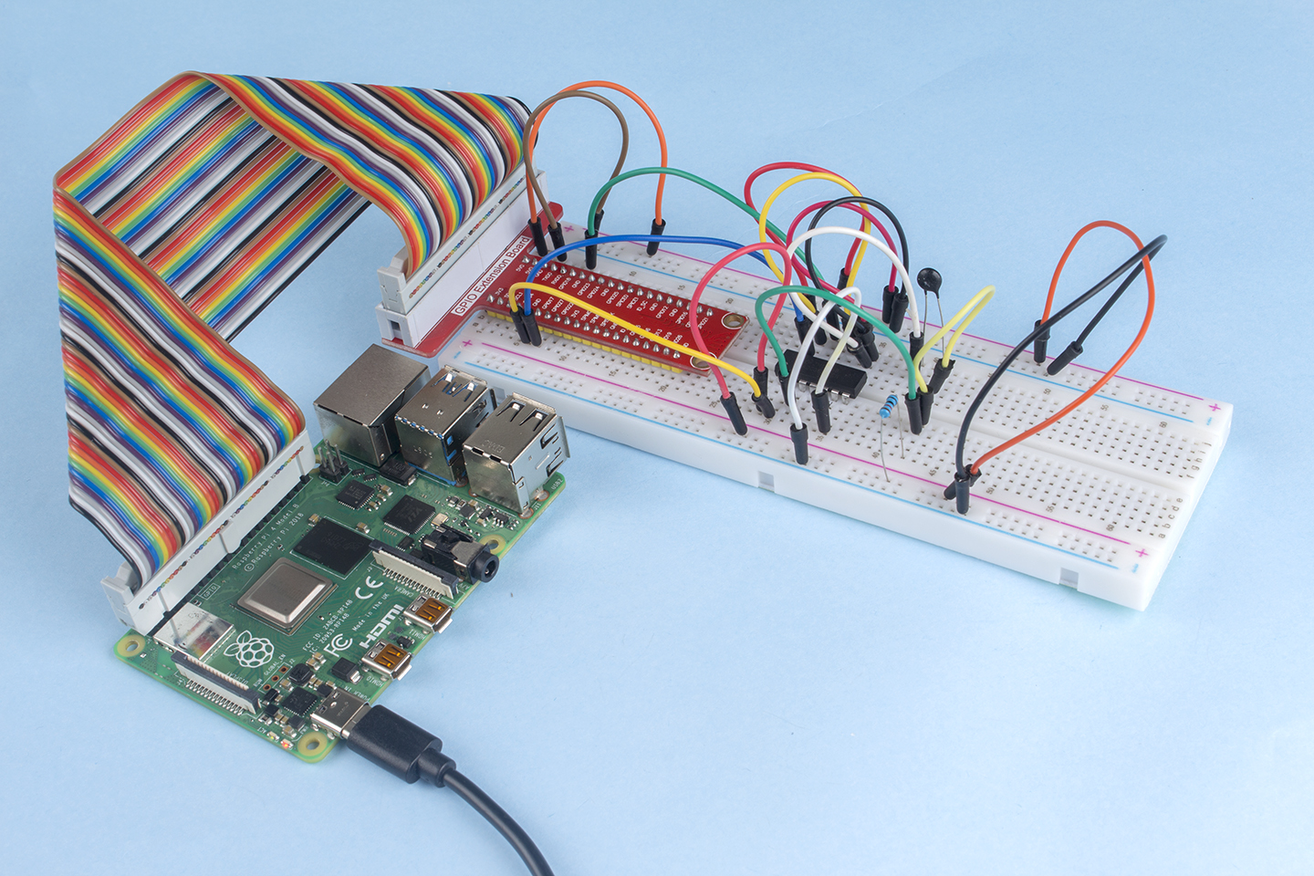

Procedure Sperimentali
../_images/image202.png
