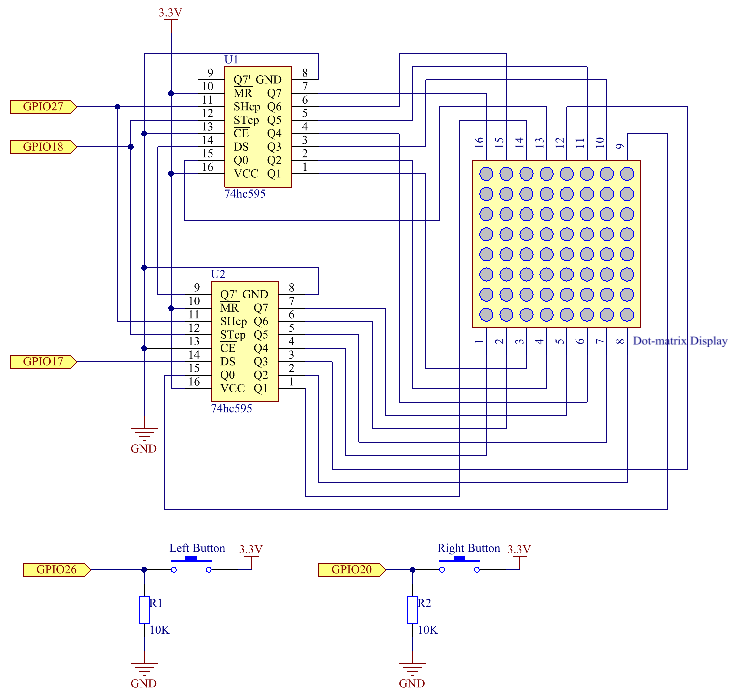

Schéma de montage
T-Board Name
physical
wiringPi
GPIO17
Pin 11
0
17
GPIO18
Pin 12
18
GPIO27
Pin 13
27
GPIO20
Pin 38
28
20
GPIO26
Pin 37
25
26
../_images/Schematic_three_one141.png

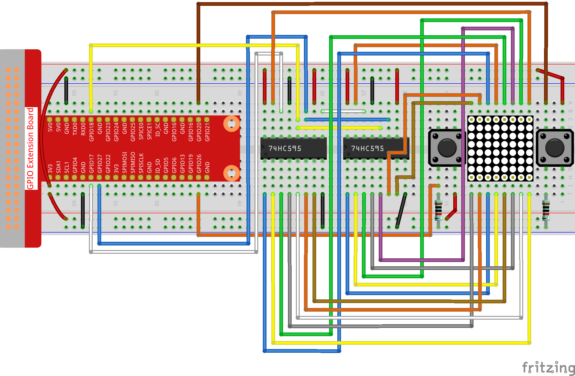

Procédures expérimentales
../_images/image2801.png
