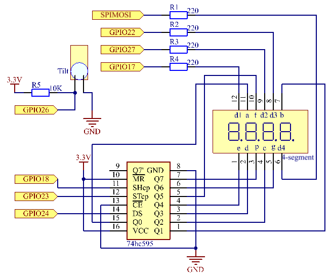

Schéma de montage
Pin 19
Pin 16
Pin 18
GPIO26
Pin 37
25
26
../_images/Schematic_three_one131.png
