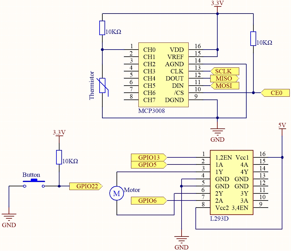

Schematic Diagram
T-Board Name
physical
wiringPi
SPICE0
Pin 24
10
8
SPIMOSI
Pin 19
12
10
SPIMISO
Pin 21
13
9
SPISCLK
Pin 23
14
11
GPIO22
Pin 15
22
GPIO5
Pin 29
21
GPIO6
Pin 31
22
GPIO13
Pin 33
23
13
../_images/schematic_3.1.4_smart_fan_mcp30081.png

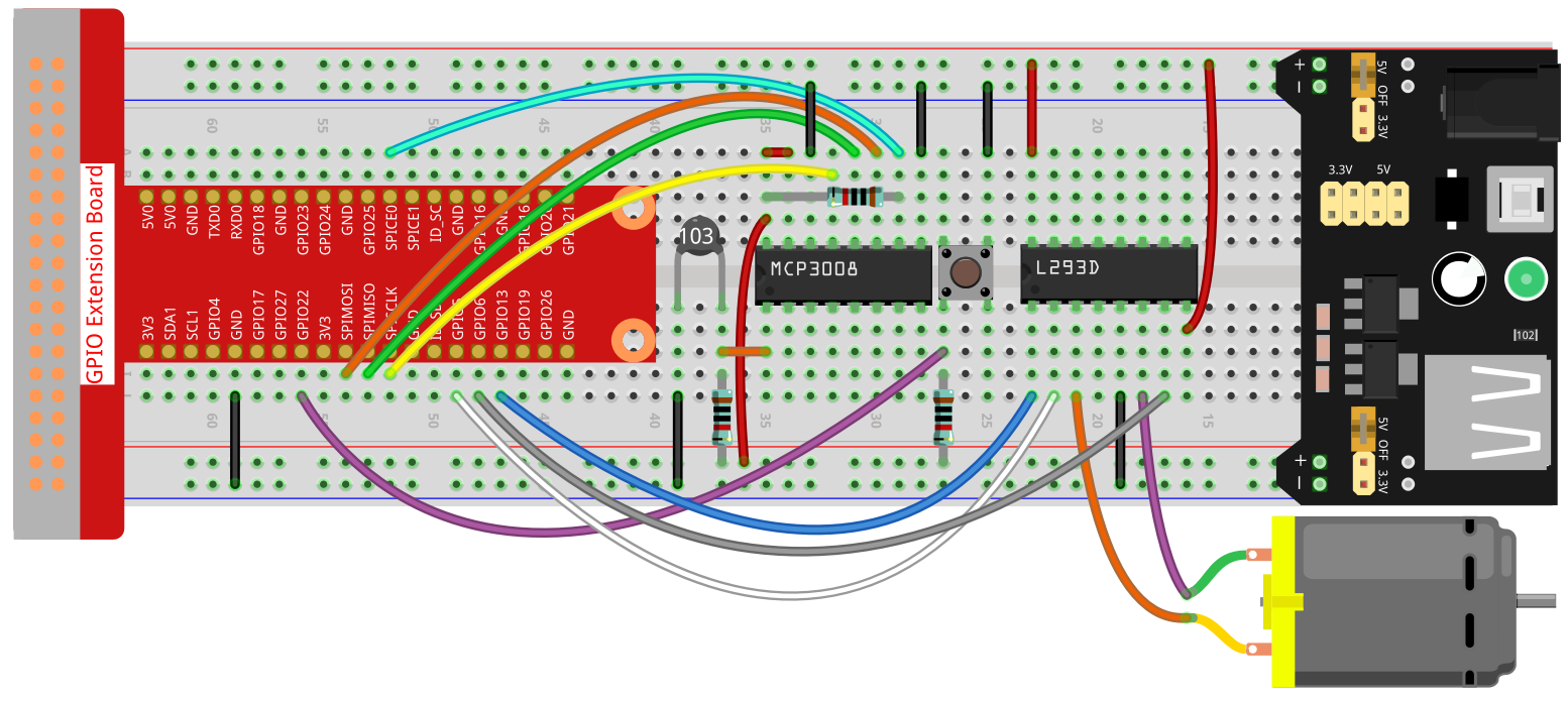

Step 1: Build the circuit.
../_images/july24_3.1.4_smart_fan_mcp30081.png
The power module can apply a 9V battery with the 9V Battery Buckle in the kit.
../_images/4.1.10_smart_fan_battery.jpeg
