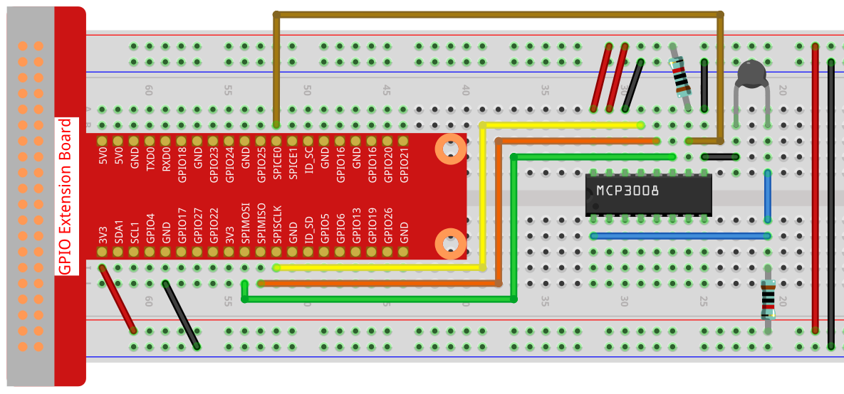

Experimental Procedures
Step 1: Build the circuit.
../_images/july24_2.2.2_thermistor_mcp30081.png
Step 2: Set up the SPI interface and install the spidev library (see SPI Configuration for detailed instructions). If you have already completed these steps, you can skip this.
Step 3: Go to the folder of the code.
Step 4: Run the executable file
sudo python3 2.2.2-2_Thermistor_zero.py
With the code run, the thermistor detects ambient temperature which will be printed on the screen once it finishes the program calculation.
