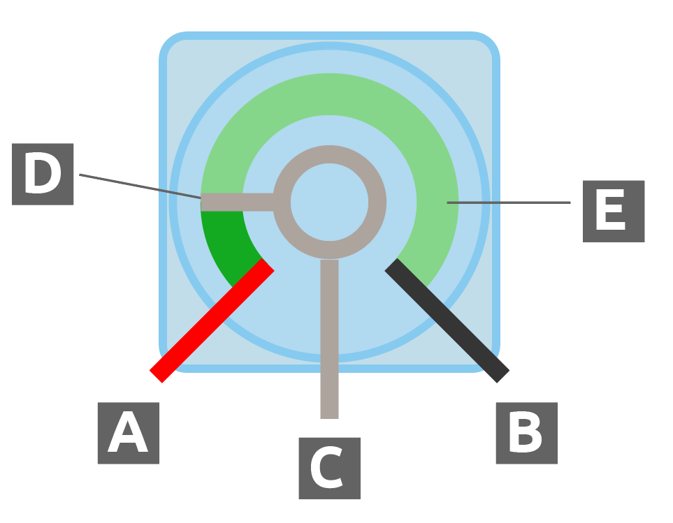

Inside the potentiometer is a strip of resistive material with a slider that moves along it. Each end of the resistive material is connected to a terminal or pin, shown below as pins A and B. The resistance between pins A and B is fixed and represents the maximum resistance the potentiometer can offer. For the ones in your kit, the maximum resistance is 10 kilo-ohms.
../_images/9_dimmer_pot_2.png
  • A: Connect to power
  • B: Connect to ground
  • C: Connect to analog pin
  • D: Slider
  • E: Resistive strip
The Pin C connects to the slider. The resistance through the slider, or Pin C, depends on the slider’s position along the resistive material.

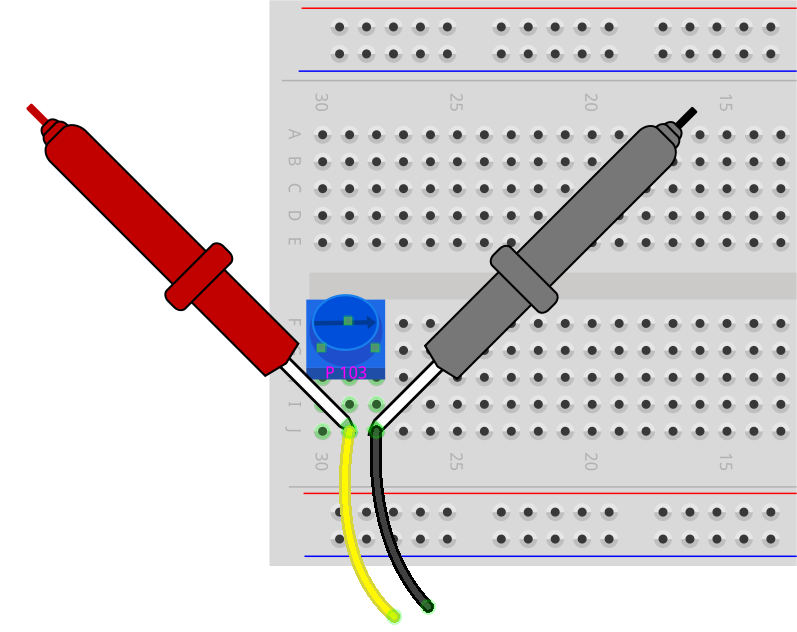

  1. To measure the resistance of the potentiometer, you need to insert a wire into 29J and then touch it with the red test lead, and insert another wire into 28J and touch it with the black lead.
../_images/9_dimmer_test_wore.png

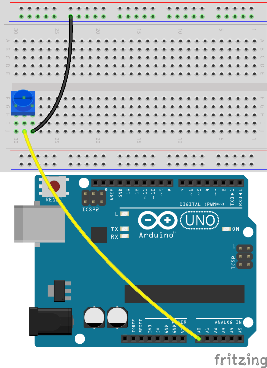

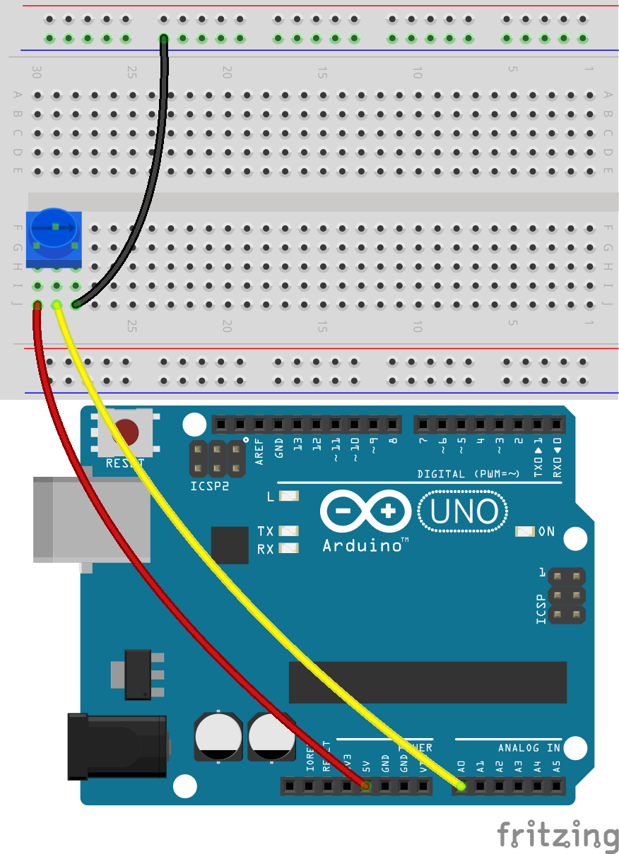

  1. Insert the other end of the jumper wire from 28J into the negative terminal of the breadboard.
../_images/9_dimmer_led1_pot_gnd.png
  1. Then, insert the other end of the jumper wire from 29J into the A0 pin of the Arduino Uno R3.
../_images/9_dimmer_led1_pot_a0.png

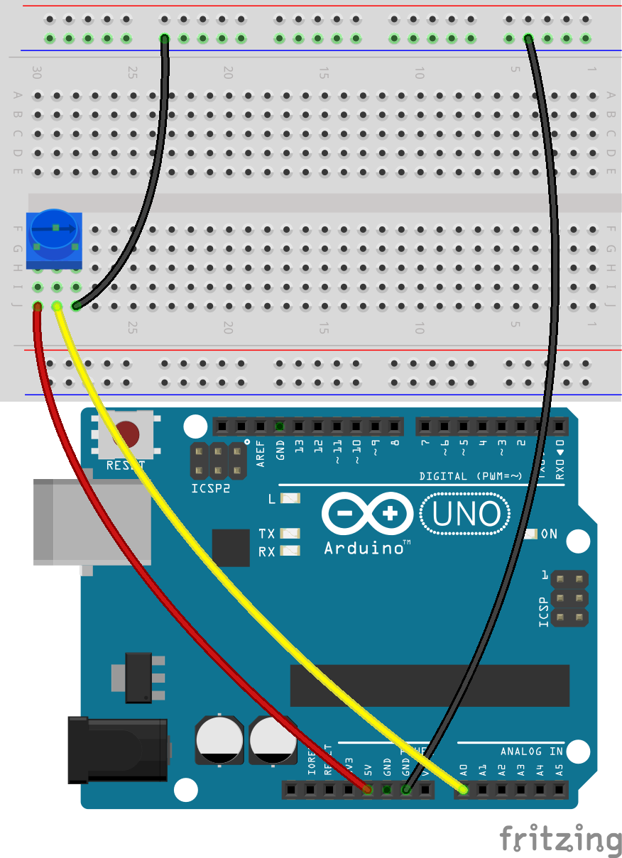

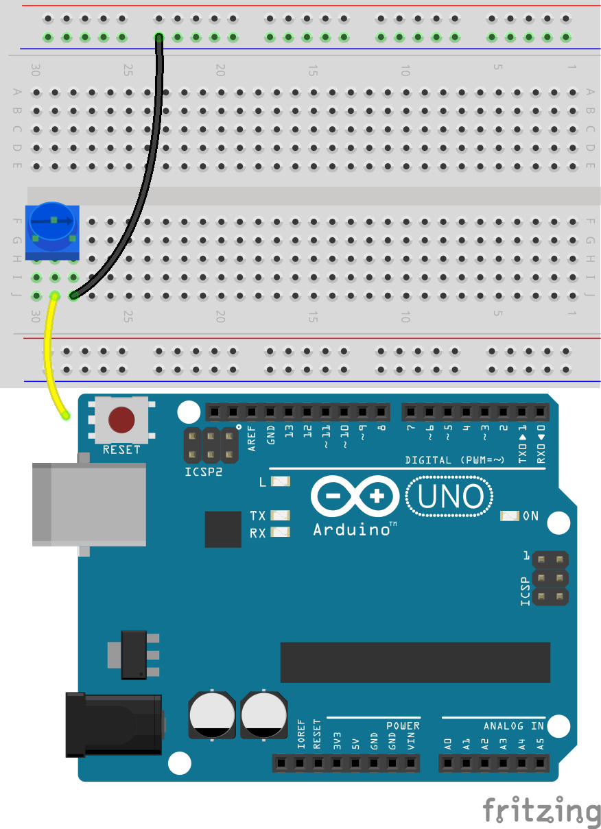

  1. Finally, connect the potentiometer to 5V by inserting a jumper wire between hole 30J on the breadboard and the 5V pin on the Arduino Uno R3.
../_images/9_dimmer_led1_pot_5v.png
  1. Connect the GND pin of the Arduino Uno R3 to the negative terminal of the breadboard using a long jumper wire.
../_images/9_dimmer_led1_gnd.png

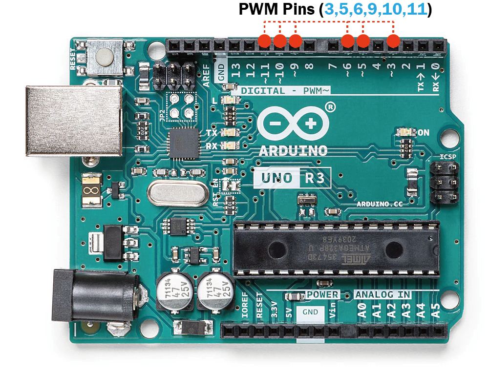

The digital pins on the Arduino Uno R3 are capable of either ON or OFF states, meaning they can’t output true analog values. To simulate analog behavior for applications like controlling LED brightness, we use a technique called Pulse Width Modulation (PWM). PWM pins, which are marked with a tilde (~) on the board, can vary the perceived output by adjusting the duty cycle of the signal.
../_images/9_dimmer_pwm_pin.png
To control an LED’s brightness, we use the analogWrite(pin, value) command. This adjusts the LED’s brightness by changing the duty cycle of the PWM signal sent to the pin.

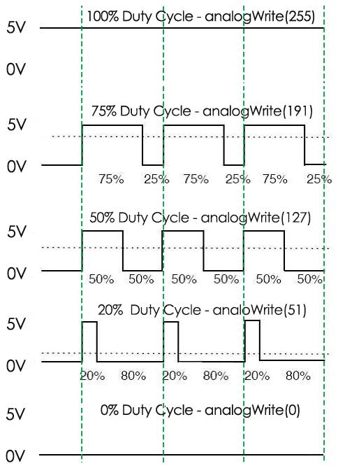

Think of the duty cycle like a faucet’s on and off pattern that controls water flow into a bucket, which represents LED brightness. Here’s a simple breakdown:
  • analogWrite(255) means the faucet is fully open all the time, making the bucket full and the LED brightest.
  • analogWrite(191) means the faucet is open 75% of the time, making the bucket less full and the LED dimmer.
  • analogWrite(0) means the faucet is completely closed, leaving the bucket empty and the LED off.
../_images/9_pwm_signal.png
  1. Add an analogWrite() command in the void loop() function and comment each line for clarity:
