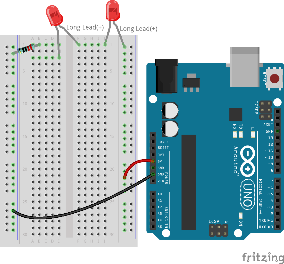

Building the Circuit
  1. Adjust the previous LED circuit by removing the jumper wire between 1J and the breadboard’s positive side on the right. Then, take another red LED and insert its cathode (the shorter leg) into 1J, and the anode into the breadboard’s positive side, so you can serially connect another LED in the circuit.
../_images/5_serial_circuit.png
Now you have a series circuit with two LEDs. Follow the current through the circuit:
  • Current flows from 5V on the Arduino Uno R3, through a long jumper wire to the breadboard’s positive terminal.
  • Then the current flows through the first LED, lighting it up due to the flow of current.
  • The current then flows through the breadboard’s metal clips to the second LED, which also lights up.
  • After leaving the second LED, it enters the 220Ω resistor, where it encounters resistance, reducing the amount of current. Without this resistor, the current through the LEDs would be too high and could burn them out.
  • It then flows back to the Arduino Uno R3’s ground pin, completing the circuit.

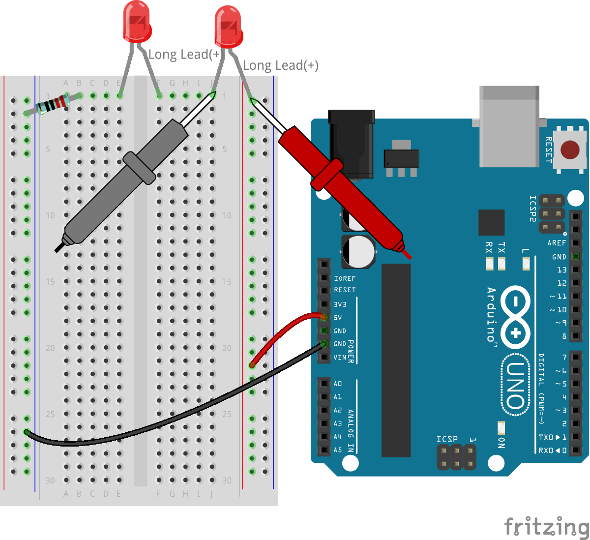

  1. Now, measure the voltage across LED 1 in the circuit.
../_images/5_serial_circuit_voltage_led1.png
  1. Record the voltage across LED 1 in the table.
Circuit
Resistor Voltage
LED1 Voltage
LED2 Voltage
Total Voltage
2 LEDs
≈1.13 volts
≈1.92 volts

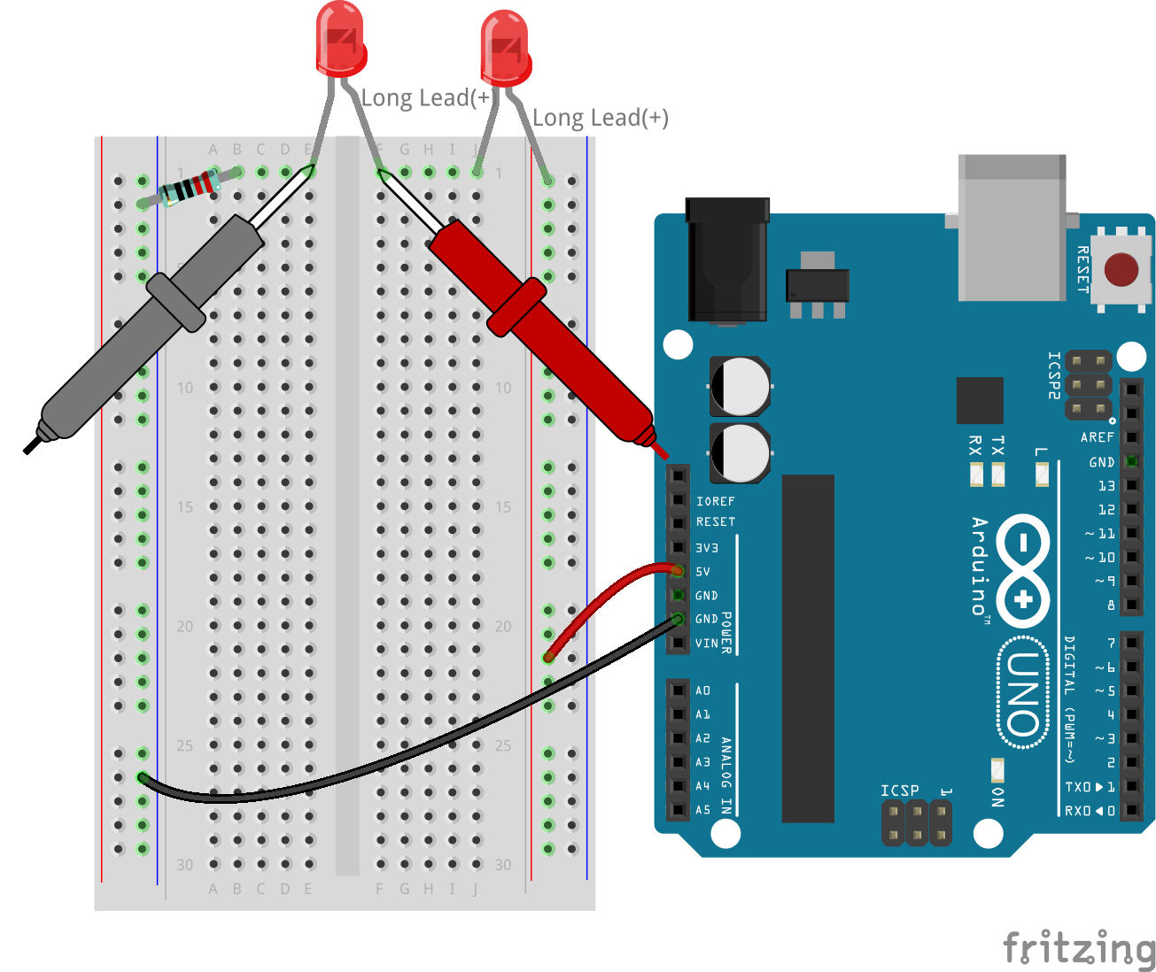

  1. Measure the voltage across LED 2 in the circuit.
../_images/5_serial_circuit_voltage_led2.png
  1. Record the voltage across LED 2 in the table.
Circuit
Resistor Voltage
LED1 Voltage
LED2 Voltage
Total Voltage
2 LEDs
≈1.13 volts
≈1.92 volts
≈1.92 volts

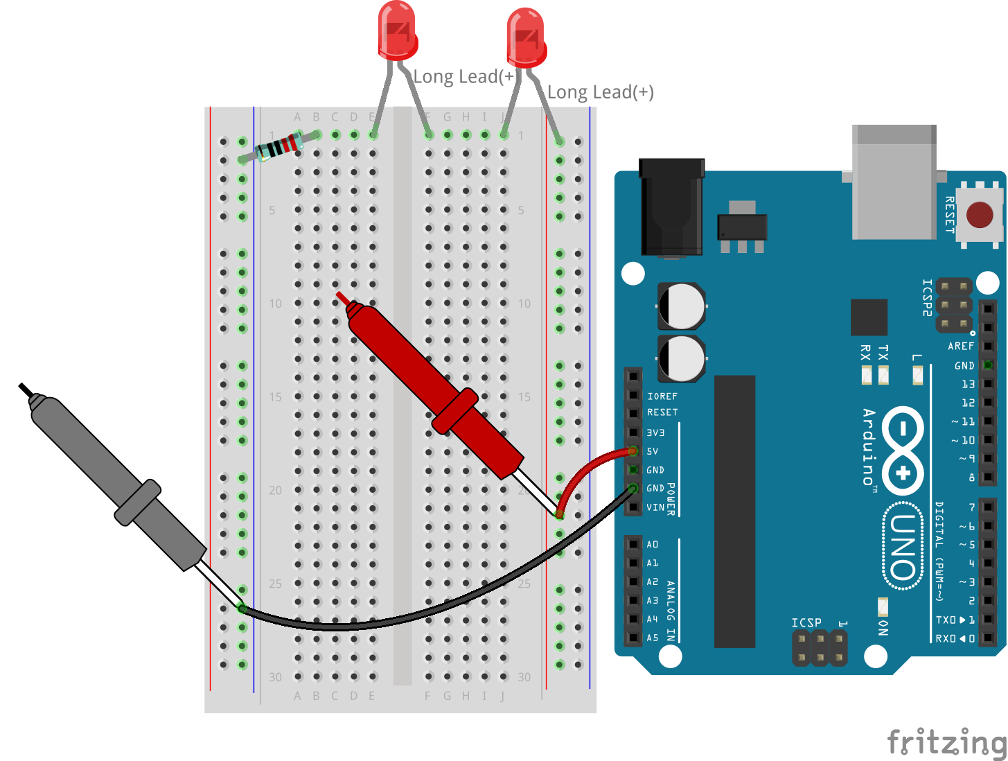

  1. Now measure the total voltage in the circuit.
../_images/5_serial_circuit_voltage.png
  1. Fill in the measured voltage into the Total Voltage column of the table.
Circuit
Resistor Voltage
LED1 Voltage
LED2 Voltage
Total Voltage
2 LEDs
≈1.13 volts
≈1.92 volts
≈1.92 volts
≈4.97 volts
Through our measurements, you will discover:
4.97 volts ≈ 1.13 volts + 1.92 volts + 1.92 volts
Total Voltage = Resistor Voltage + LED 1 Voltage + LED 2 Voltage
You can also calculate whether your measurement results conform to the above equation.
Due to wiring stability, or minor manufacturing differences in the LEDs and resistor, the sum of the resistor voltage and the two LEDs’ voltages might not equal the total voltage you measured. This is also okay, as long as it’s within a reasonable range.
This is a characteristic of a series circuit, where the total voltage across the circuit is the sum of the voltages across each component.

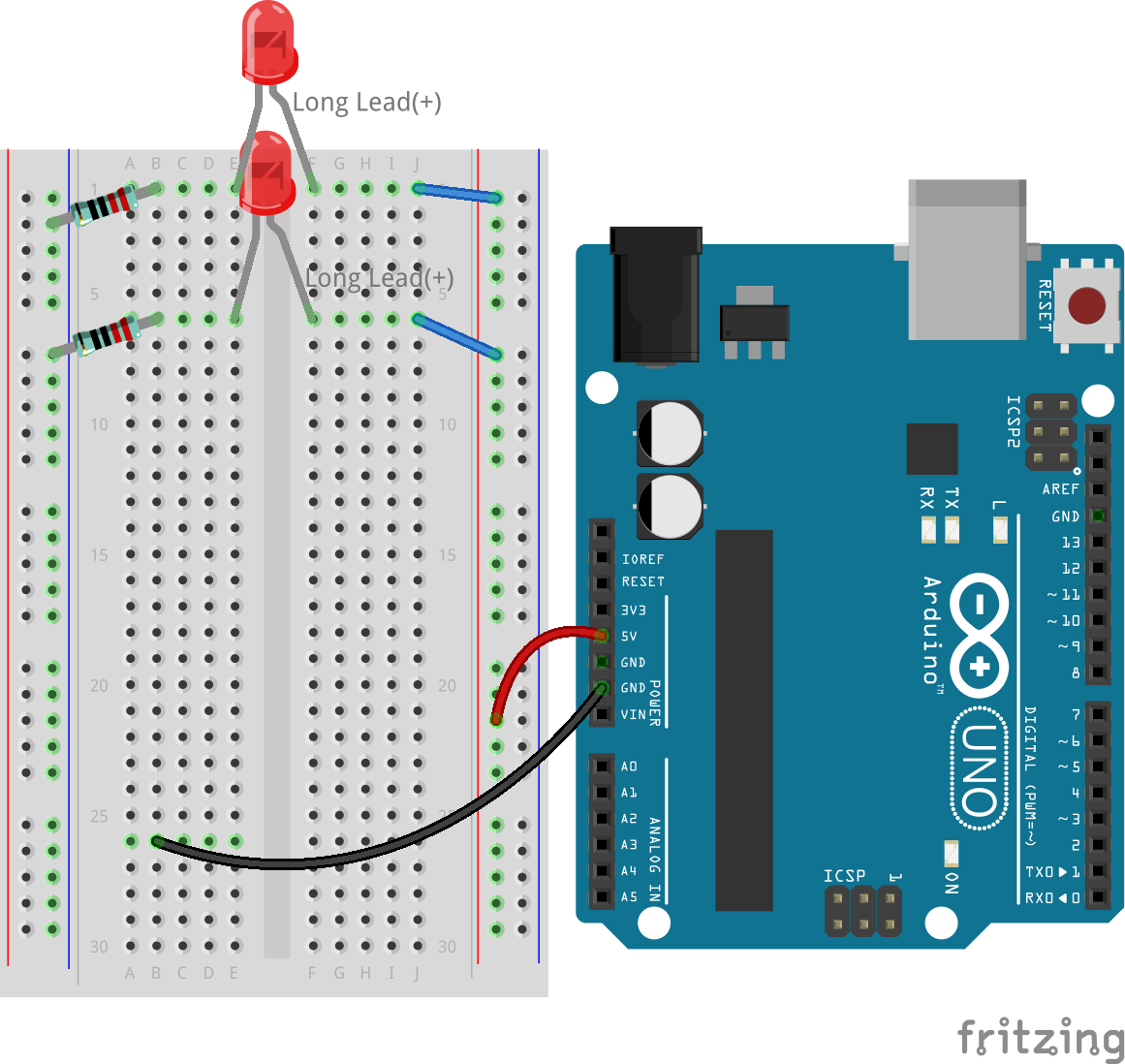

../_images/5_parallel_circuit_bb.png
  1. Connect a 220Ω resistor to the breadboard. One end should be in the negative terminal, and the other end should be in hole 1B.
../_images/2_connect_resistor.png
  1. Add a red LED to the breadboard. The LED’s anode (long leg) should be in hole 1F. The cathode (short leg) should be in hole 1E.
../_images/2_connect_led.png
  1. Use a short jumper wire to connect the LED and the power source. One end of the jumper wire should be in hole 1J. The other end should be in the positive terminal.
../_images/2_connect_wire.png
  1. Connect the long jumper wire connected to the breadboard’s positive terminal to the 5V pin on the Arduino Uno R3. The LED should turn on and stay on. The 5V pin provides a constant 5 volts DC to the circuit. This is different from pin 13, which can be programmed via the Arduino IDE software to turn on and off.
../_images/5_parallel_circuit_5v.png
  1. Connect the breadboard’s negative terminal to one of the ground pins on the Arduino Uno R3. The ground pins are marked as “GND”.
../_images/5_parallel_circuit_gnd.png
  1. Take another 220Ω resistor, connect one end to the negative terminal and the other end to hole 6B.
../_images/5_parallel_circuit_resistor.png
  1. Take another red LED. The LED’s anode (long leg) should be in hole 6F. The cathode (short leg) should be in hole 6E.
../_images/5_parallel_circuit_led.png
  1. Finally, place one end of a short jumper wire in hole 6J and the other end in the positive terminal. This completes the parallel circuit.
Now, this circuit has two LEDs in a parallel configuration. There are two paths for current to flow through:
  • In the first path: current enters the first LED from the jumper wire, flows through the current-limiting resistor, and then to the negative side of the breadboard.
  • In the second path: current enters the second LED from the jumper wire, flows through the current-limiting resistor, and then to the negative side of the breadboard.
  • At the negative side, the two paths converge again and then flow through the black power wire to reach the ground pin on the Arduino Uno R3.

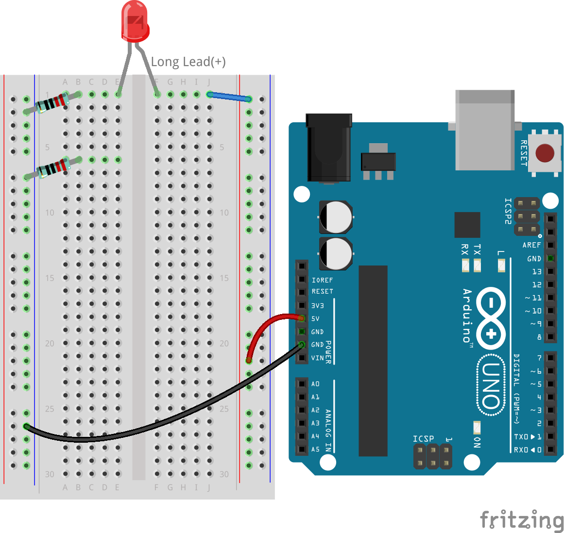

Question:
In this parallel circuit, what happens if one LED is removed? Why does this occur?
../_images/5_parallel_circuit_remove.png

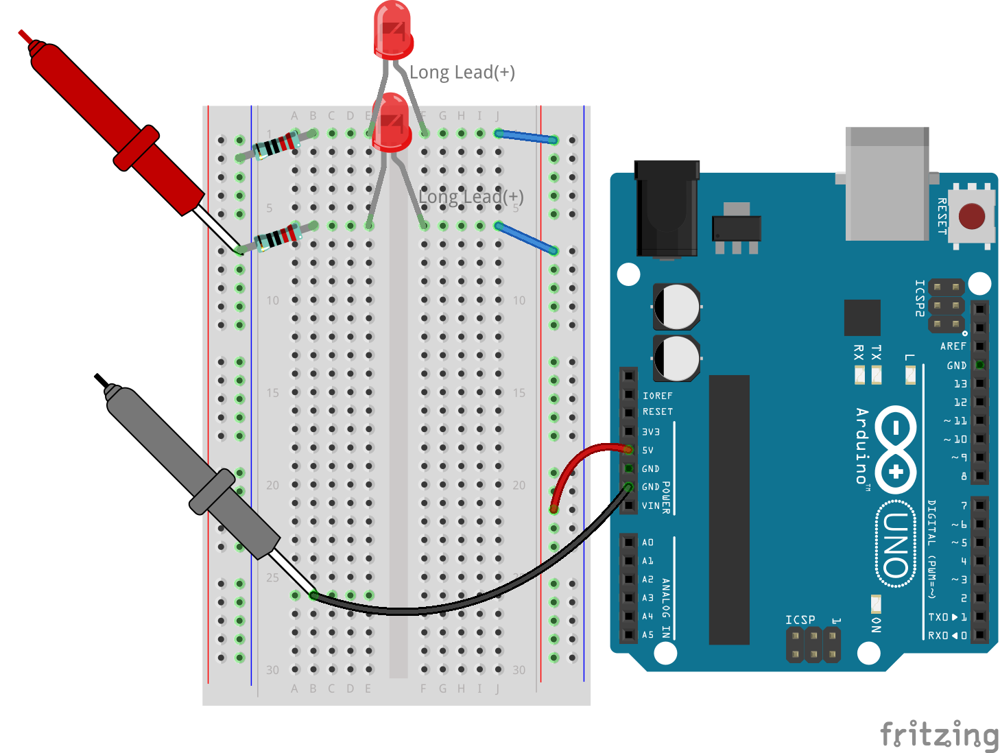

Voltage Measurement Steps
  1. Adjust the multimeter to the DC 20 volts mode.
../_images/multimeter_dc_20v.png
  1. Remember, in a parallel circuit, each branch gets the entire voltage from the power source. So, each branch in your setup should show around 5 volts. Start by measuring the voltage along the first path.
../_images/5_parallel_circuit_voltage1.png
Circuit
Path1 Voltage
Path2 Voltage
2 LEDs

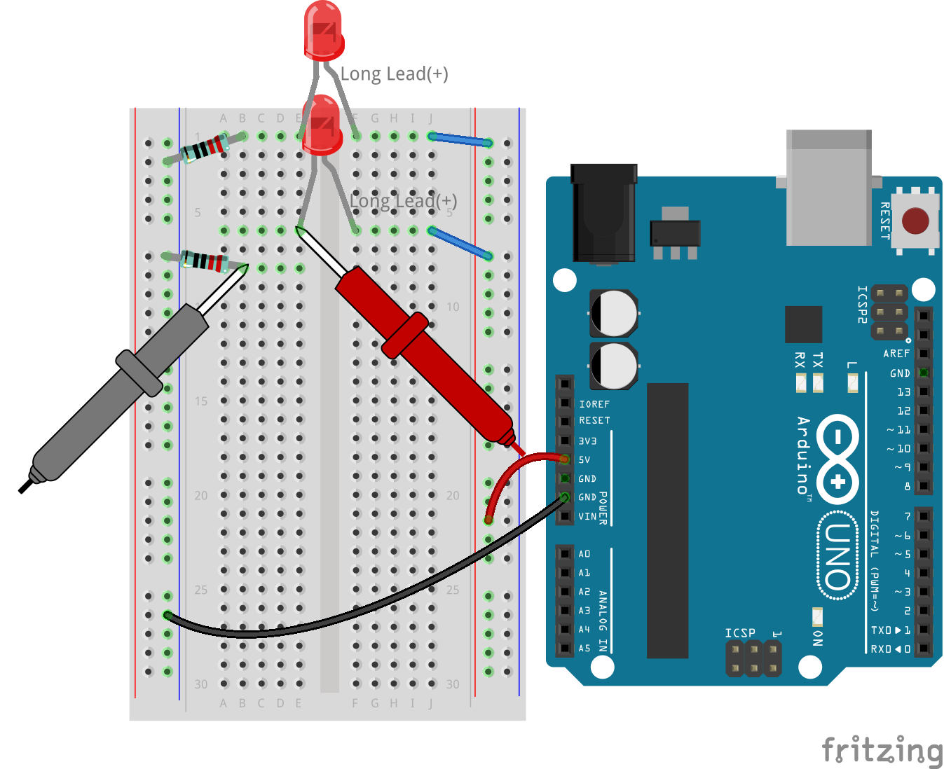

≈5.00 volts
  1. Next, check the voltage drop across the second path. Expect it to be near 5 volts as well.
../_images/5_parallel_circuit_voltage2.png
Circuit
Path1 Voltage
Path2 Voltage
2 LEDs
≈5.00 volts
≈5.00 volts
Our voltage measurement exercise in a parallel circuit clearly demonstrates that each branch receives an equal share of the total voltage from the source, approximately 5 volts in this case. This consistency across different paths confirms the fundamental nature of parallel circuits, where voltage remains constant across each branch, despite potential minor variations due to manufacturing differences in components like LEDs and resistors.
