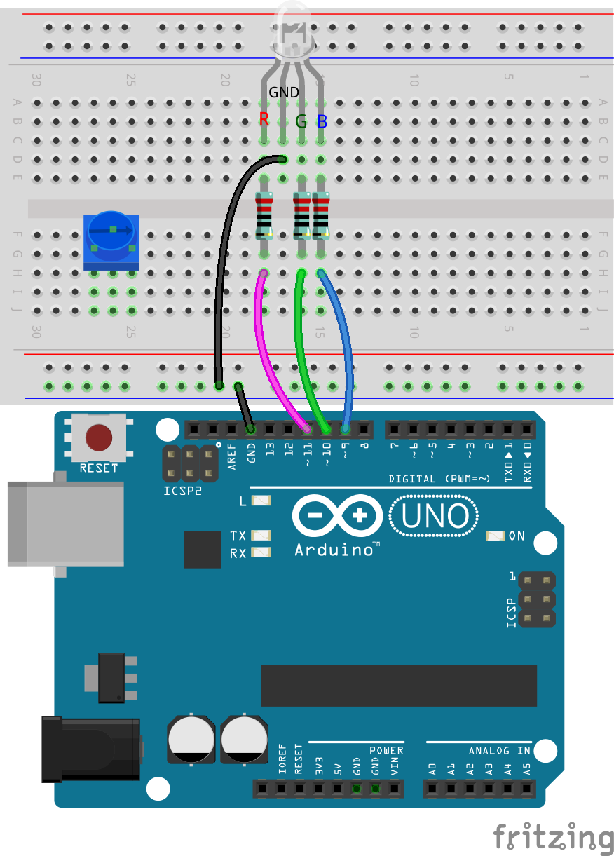

This circuit builds upon the one from Lesson 12 by adding a potentiometer.
../_images/15_cool_warm_color.png
  1. Remove the jumper wire connecting the GND pin of the Arduino Uno R3 to the GND pin of the RGB LED and then insert it into the negative terminal of the breadboard. Then, connect a jumper wire from the negative terminal to the GND pin of the RGB LED.
../_images/15_cool_warm_color_gnd.png
  1. Insert the potentiometer into holes 25G, 26F, and 27G.
../_images/15_cool_warm_color_pot.png
  1. Connect the middle pin of the potentiometer to the A0 pin of the Arduino Uno R3.
../_images/15_cool_warm_color_a0.png
  1. Finally, connect the left pin of the potentiometer to the 5V pin on the Arduino Uno R3 and the right pin to the negative terminal on the breadboard.

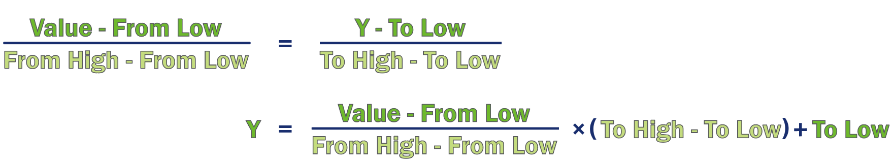

The map() function scales a value from its original range (fromLow to fromHigh) to a new range (toLow to toHigh). First, it calculates the position of the value within its original range, then applies the same proportion to scale this position to the new range.
../_images/15_map_pic.png
So it can be written as the formula shown below:
(value-fromLow)/(fromHigh-fromLow) = (y-toLow)/(toHigh-toLow)
Using algebra, you can rearrange this equation to solve for y:
y = (value-fromLow) * (toHigh-toLow) / (fromHigh-fromLow) + toLow
../_images/15_map_format.png
For instance, using y = map(value, 0, 1023, 246, 100);, if value equals 434, then y = (434-0) * (100 - 246) / (1023-0) + 246, which approximately equals 152.

Note that the “lower bounds” of either range may be larger or smaller than the “upper bounds”, so the map(value, fromLow, fromHigh, toLow, toHigh) function may be used to reverse a range of numbers, for example:
y = map(x, 1, 50, 50, 1);
The function also handles negative numbers well, so that this example is also valid and works well.
y = map(x, 1, 50, 50, -100);
For y = map(x, 1, 50, 50, -100);, if x equals 20, what should y be? Refer to the following formula to calculate it.
