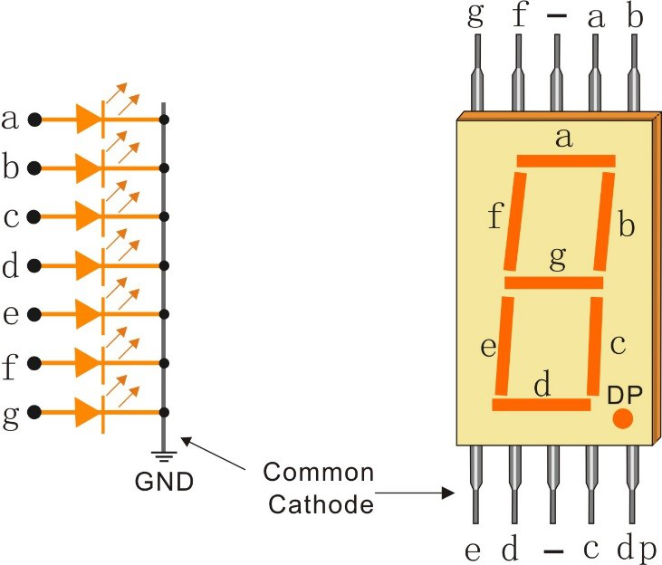

Understanding the 7-Segment Display
  1. Find a 7-segment display.
A 7-segment display is an 8-shaped component that packages 7 LEDs. Each of the LEDs in the display is given a positional segment with one of its connection pins led out from the rectangular plastic package. These LED pins are labeled from “a” to “g” representing each individual LED. The other LED pins are connected together forming a common pin. An additional 8th LED used within the same package thus allowing the indication of a decimal point (DP) when two or more 7-segment displays are connected together to display numbers greater than ten.
../_images/23_7_segment.png
The common pin of the display generally tells its type. There are two types of pin connections: one with connected cathodes and another with connected anodes, indicating Common Cathode (CC) and Common Anode (CA). As the name suggests, a CC display has all the cathodes of the 7 LEDs connected, while a CA display has all the anodes of the 7 segments connected.
Usually, there is a label on the side of the 7-segment display, xxxAx or xxxBx. Generally, xxxAx stands for common cathode and xxxBx stands for common anode. The displays in our kit are common cathode.

Question
From the tests above, it is known that the display in the kit is common cathode, which means you only need to connect the common pin to GND and provide a high voltage to the other pins to light up the corresponding segments. If you want the display to show the number 2, which pins should be provided with a high voltage? Why?

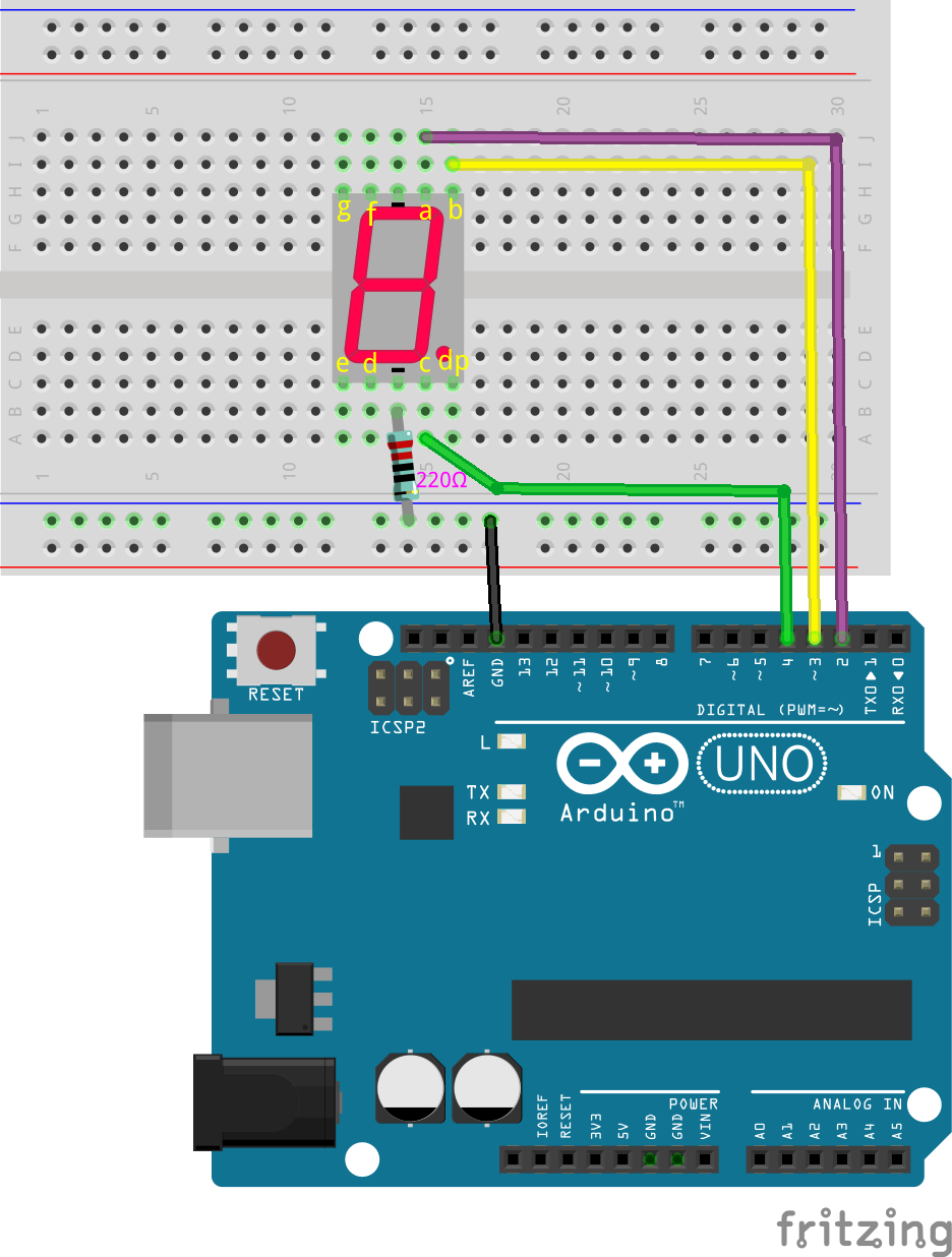

Building Step-by-Step
Follow the wiring diagram, or the steps below to build your circuit.
../_images/23_segment_5v.png
  1. Insert the 7-segment display into the breadboard with the decimal point at the bottom right corner.
../_images/23_segment_segment.png
  1. Insert one end of a 220Ω resistor into the negative (“-”) terminal of the 7-segment display, and the other end into the negative rail of the breadboard. Then connect the breadboard’s negative rail to the GND pin of the Arduino Uno R3 with a jumper wire.
../_images/23_segment_resistor_gnd.png
  1. Connect the pins controlling the a, b, c segments of the LED to pins 2, 3, and 4 on the Arduino Uno R3.
../_images/23_segment_abc.png
  1. Connect the pins controlling the d, e, f, g segments of the LED to pins 5, 6, 7, and 8 on the Arduino Uno R3.

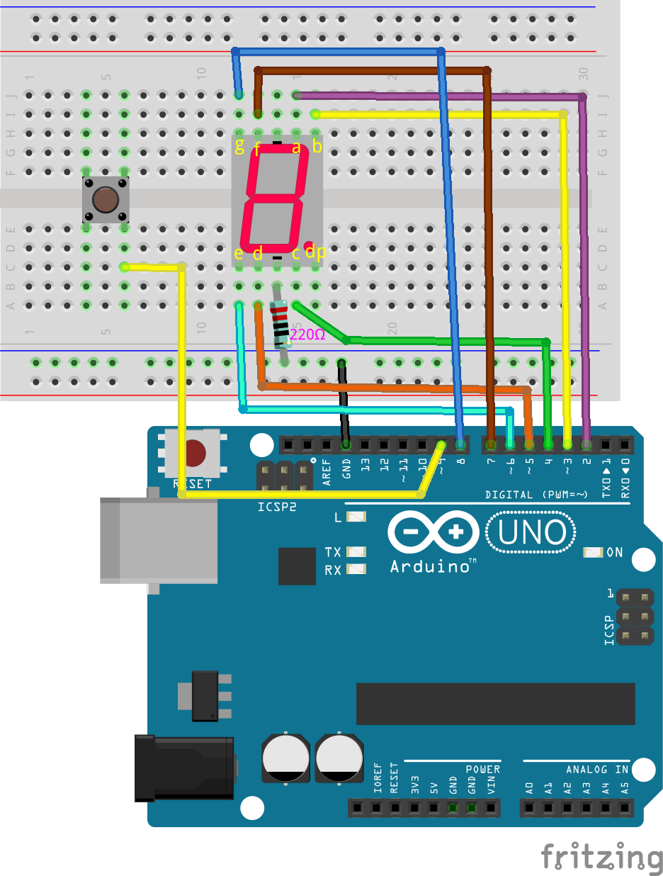

../_images/23_segment_defg.png
  1. Now insert a button into the breadboard.
../_images/23_segment_button.png
  1. Connect the lower right pin of the button to pin 9 of R3 with a wire.
../_images/23_segment_pin9.png
  1. Connect a 10K pull-down resistor to the button so that when the button is not pressed, pin 9 remains at a low level and does not bounce.
../_images/23_segment_10k_resistor.png
  1. Connect the lower left pin of the button to the 5V on the Arduino Uno R3.
