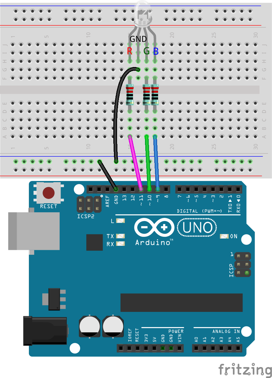

  1. Based on the circuit of lesson12, remove the jumper wire connecting the GND pin of the Arduino Uno R3 to the GND pin of the RGB LED and then insert it into the negative terminal of the breadboard. Then, connect a jumper wire from the negative terminal to the GND pin of the RGB LED.
../_images/16_temperature_alarm_gnd.png

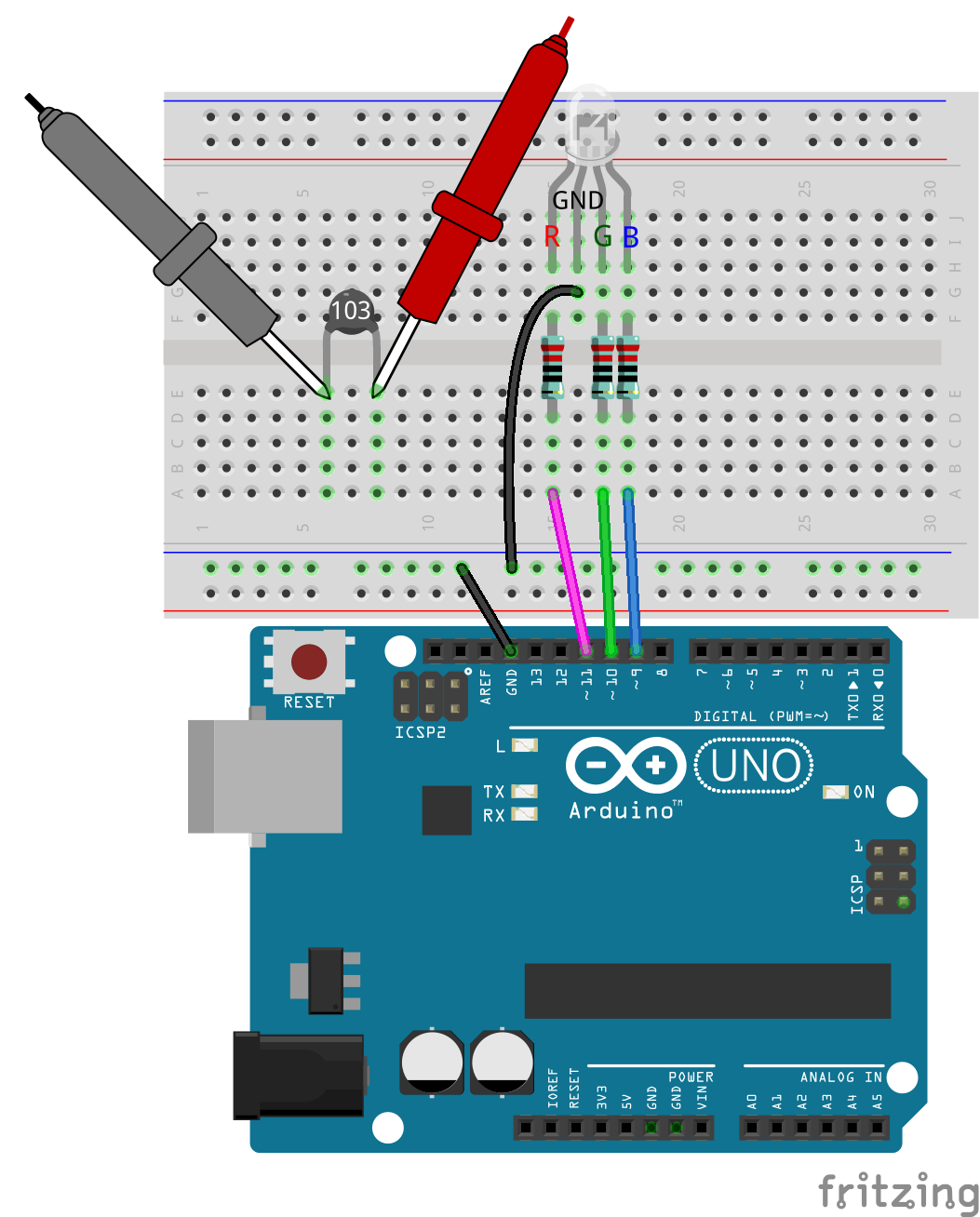

Now use a multimeter to measure the resistance of this thermistor to see if it indeed decreases with an increase in temperature.
  1. Since the rated resistance of the thermistor is 10K, set the multimeter to measure resistance in the 20 kilo-ohm (20K) range.
../_images/multimeter_20k.png
  1. Now, touch the two pins of the photoresistor with the red and black test leads of the multimeter.
../_images/16_temperature_alarm_test.png

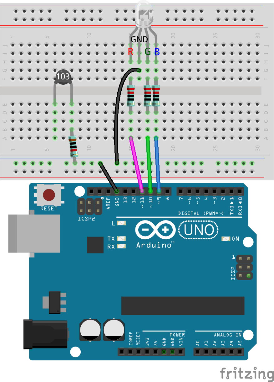

  1. Now you can continue building the circuit. Connect one end of the thermistor to a 10K resistor, and the other end of the 10K resistor to the negative terminal of the breadboard.
../_images/16_temperature_alarm_resistor.png
  1. Connect the other end of the breadboard to the 5V pin of the Arduino Uno R3.
../_images/16_temperature_alarm_5v.png
