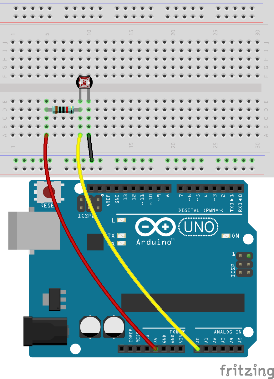

  1. Continue building the circuit. Connect one pin of the photoresistor to the negative terminal of the breadboard and the other pin to the A0 pin on the Arduino Uno R3.
../_images/17_light_alarm_a0.png
  1. Insert a 10K resistor in the same row as the photoresistor’s connection to A0.
../_images/17_light_alarm_resistor.png
In this circuit, the 10K resistor and the photoresistor are connected in series, and the current passing through them is the same. The 10K resistor acts as a protection, and the A0 pin reads the value after the voltage conversion of the photoresistor.
When the light is enhanced, the resistance of the photoresistor decreases, then its voltage decreases, so the value from the A0 pin will decrease; if the light is strong enough, the resistance of the photoresistor will be close to 0, and the value of the A0 pin will be close to 0. At this time, the 10K resistor plays a protective role, preventing a short circuit by keeping the 5V and GND from being directly connected.
If you place the photoresistor in a dark situation, the value of the A0 pin will increase. In a dark enough situation, the resistance of the photoresistor will be infinite, and its voltage will be close to 5V (the 10K resistor becomes negligible), and the value of the A0 pin will be close to 1023.
  1. Connect the other pin of the 10K resistor to the 5V pin on the Arduino Uno R3.
../_images/17_light_alarm_5v.png
  1. Next, as in the previous lesson, insert the active buzzer into the breadboard, connecting its anode to pin 9 of the R3 and its cathode to the negative terminal of the breadboard.
../_images/17_light_alarm_buzzer.png
  1. Finally, connect the negative terminal of the breadboard to the GND pin on the Arduino Uno R3 with a jumper wire.
../_images/17_light_alarm.png
