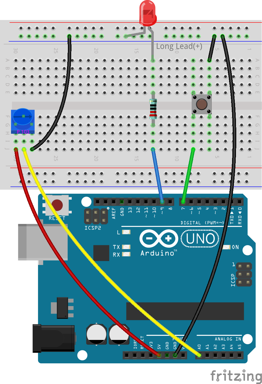

  1. Start with the desk lamp circuit from the previous lesson.
../_images/9_dimmer_led1_pin9.png
  1. Insert the button into the breadboard across the middle gap, with pins in holes 6E, 8E, 6J and 8J.
If you’re unsure how to insert the button, try both orientations. One way, the pin spacing will be slightly too narrow to fit.
../_images/10_desk_lamp_button_button.png
  1. Connect the button’s buttom-left pin to digital pin 7 on the Arduino Uno R3 with a long jumper wire, inserting one end into hole 8J and the other into pin 7.
../_images/10_desk_lamp_button_p7.png
  1. Connect the button’s top-right pin to the breadboard’s negative rail with a short jumper wire, inserting one end into hole 6A and the other into the negative rail.
../_images/10_desk_lamp_button_gnd.png

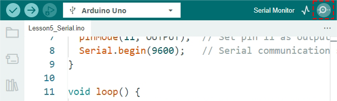

  2. Afterward, click on the “Serial Monitor” button in the top right corner of the Arduino IDE.

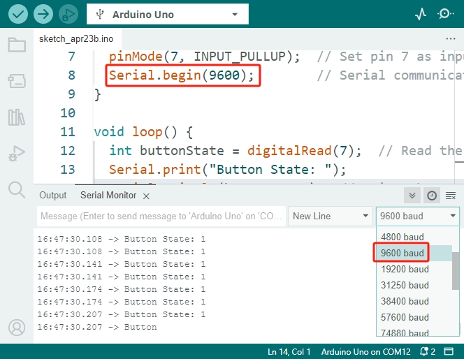

  3. If you see garbled data displayed, you will need to adjust the baud rate to match the one set in your code.

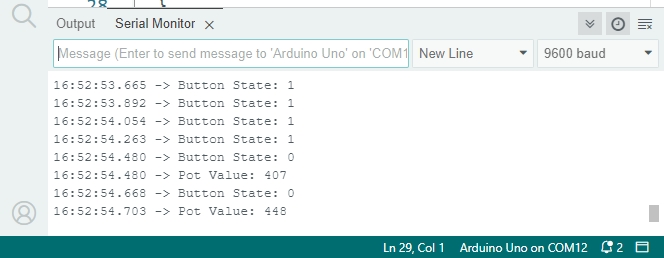

  4. You will find that when the button is not pressed, it continuously prints “1”, and when the button is pressed, it continuously prints “0”. This is the characteristic of a digital signal, which has only two states: “0” and “1”.

  2. Open the Serial Monitor to view the output data. You will notice that the button state prints “1” continuously when not pressed and “0” for the moment the button is pressed. At the same time, the value from the potentiometer will also be printed. As you rotate the potentiometer, you’ll observe in the Serial Monitor that the higher the value, the brighter the LED becomes, and vice versa.
