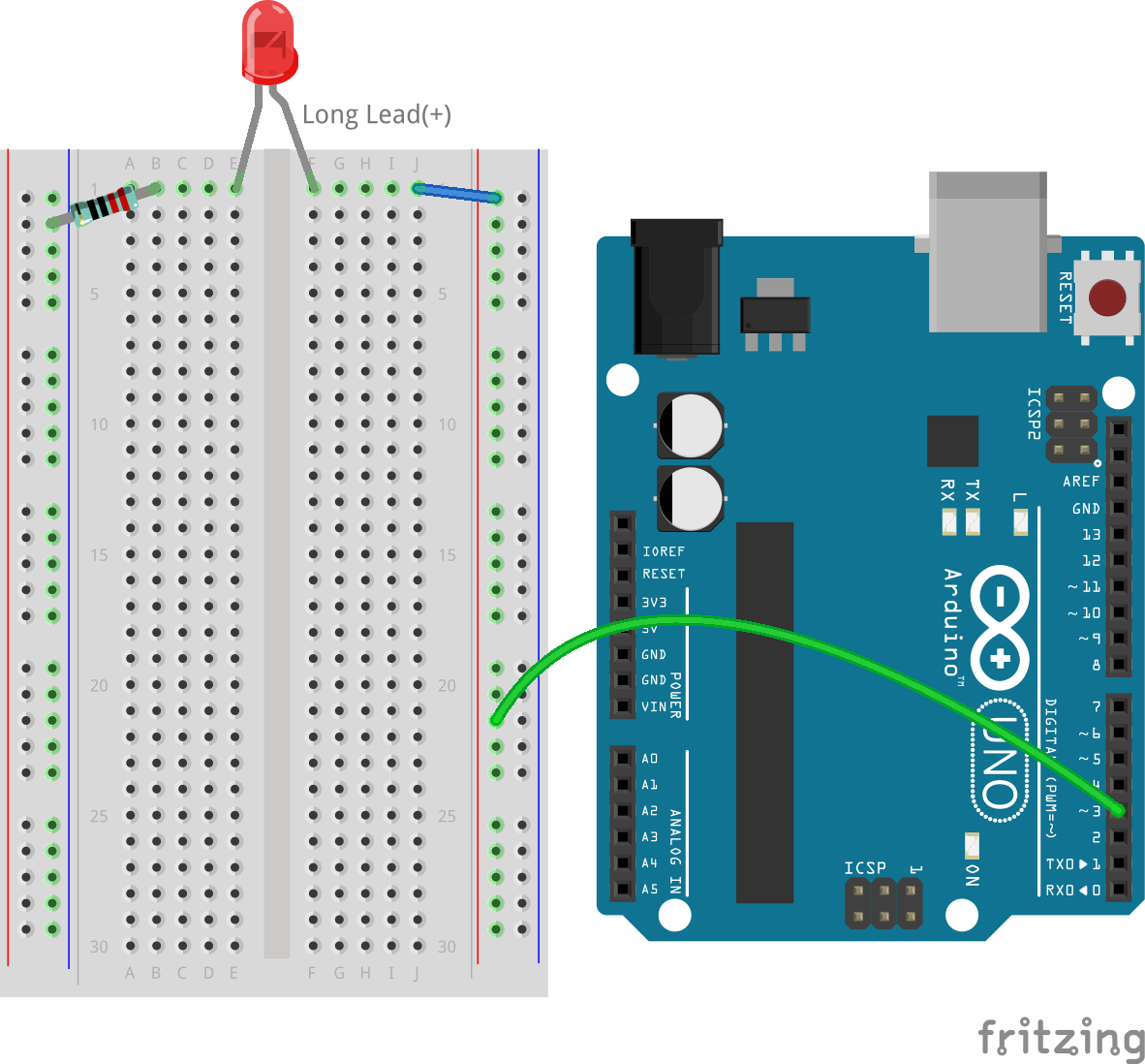

Take the circuit built in 2. Your First Circuit, and switch the wire from the 5V to pin 3, as shown in the image below.
If you’ve dismantled the previous circuit, you can rebuild it following these steps:
Connect the 220 ohm resistor to the breadboard. One wire should be in the negative terminal, and the other wire should be in hole 1B.
Add a red LED to the breadboard. The LED’s anode (long leg) should be in hole 1F. The cathode (short leg) should be in hole 1E. Sometimes it’s hard to distinguish the anode from the cathode by the length of the legs. Remember, the cathode side of the LED also has a flat edge on the colored lens, while the anode has a round edge.
Use a short jumper wire to connect the LED and the power source. One end of the jumper wire should be in hole 1J. The other end should be in the positive terminal.
Connect the breadboard’s positive terminal to pin 3 on the Arduino Uno R3.
Connect the breadboard’s negative terminal to one of the ground pins on the Arduino Uno R3. The ground pins are marked as “GND”.

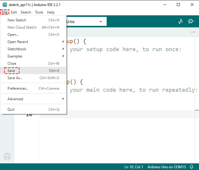

1. Creating and Saving a Sketch
Fire up the Arduino IDE. Go to the “File” menu and hit “New Sketch” to start fresh. You can close any other sketch windows that might be open.
Arrange the Arduino IDE window side by side with this online tutorial, so you can see both at once. Things might look a bit small, but it beats flipping back and forth between windows.
Time to save your sketch. Hit “Save” from the “File” menu or press
Ctrl + S.
You can save your sketch in the default location or another place. Name your sketch something meaningful, like
Lesson6_Light_up_LED, and click “Save”.Naming your sketch after its function for easy later retrieval.
Arduino sketch filenames can’t have spaces.
When saving significant changes, consider saving as a new version (e.g., V1) for backup.
