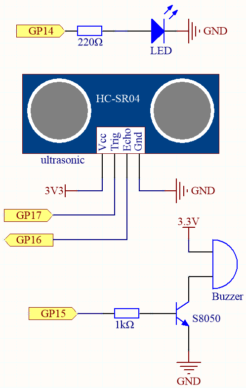

Schéma
sch_reversing_aid

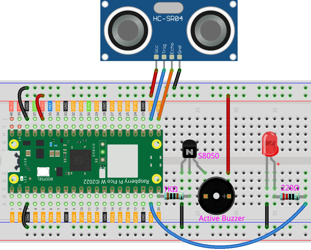

Câblage
wiring_reversing_aid
