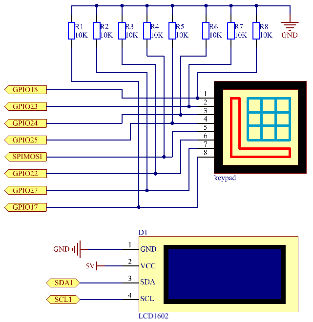

Schematic Diagram
T-Board Name
physical
wiringPi
GPIO18
Pin 12
18
GPIO23
Pin 16
23
GPIO24
Pin 18
24
GPIO25
Pin 22
25
GPIO17
Pin 11
0
17
GPIO27
Pin 13
27
GPIO22
Pin 15
22
SPIMOSI
Pin 19
12
10
SDA1
Pin 3
SCL1
Pin 5
../_images/Schematic_three_one91.png

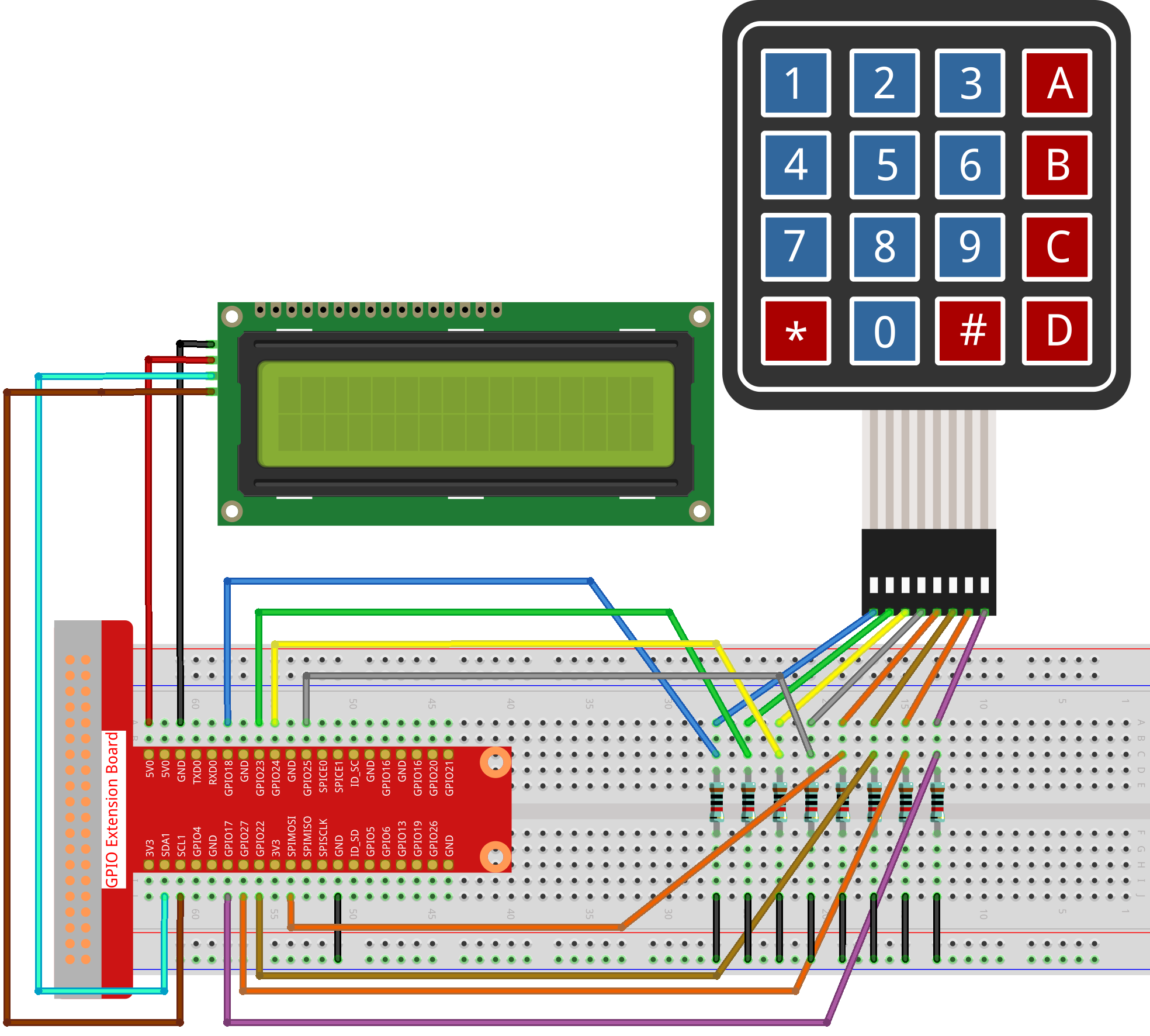

Experimental Procedures
Step 1: Build the circuit.
../_images/image2621.png
