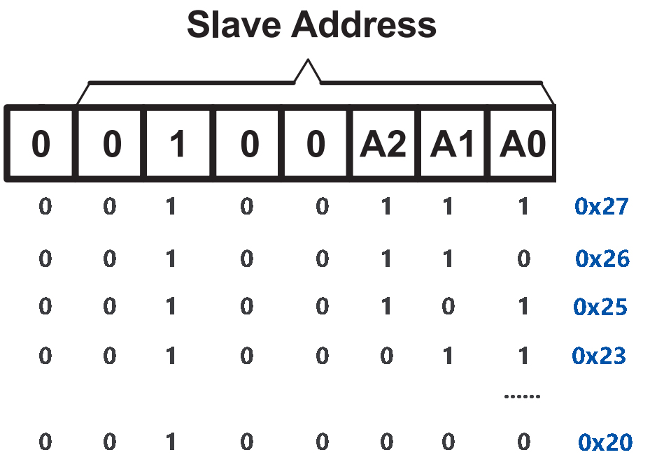

I2C Address
The default address is basically 0x27, in a few cases it may be 0x3F.
Taking the default address of 0x27 as an example, the device address can be modified by shorting the A0/A1/A2 pads; in the default state, A0/A1/A2 is 1, and if the pad is shorted, A0/A1/A2 is 0.
../_images/i2c_address2.jpg

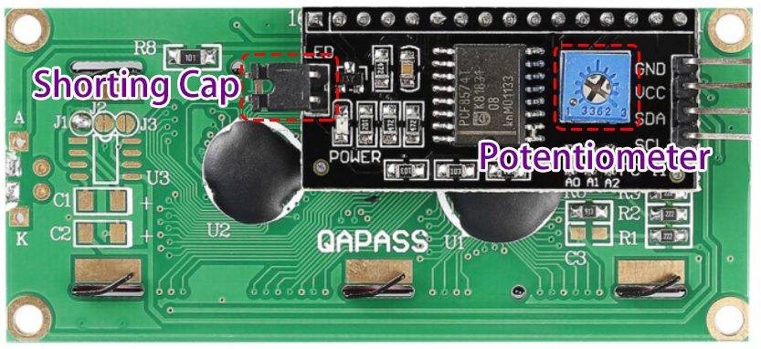

Backlight/Contrast
Backlight can be enabled by jumper cap, unplugg the jumper cap to disable the backlight. The blue potentiometer on the back is used to adjust the contrast (the ratio of brightness between the brightest white and the darkest black).
../_images/back_lcd16022.jpg
  • Shorting Cap: Backlight can be enabled by this cap,unplugg this cap to disable the backlight.
  • Potentiometer: It is used to adjust the contrast (the clarity of the displayed text), which is increased in the clockwise direction and decreased in the counterclockwise direction.

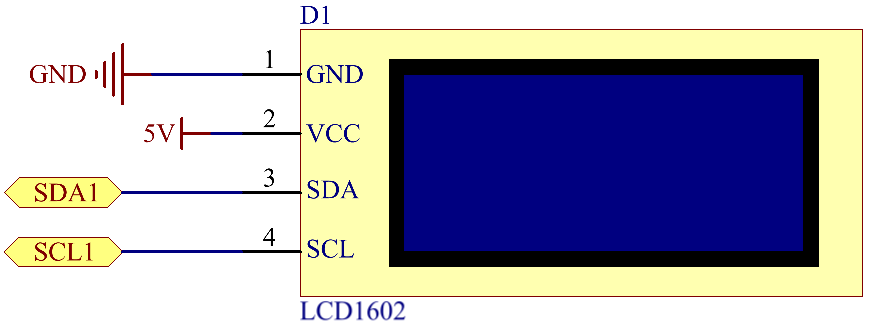

Schematic Diagram
T-Board Name
physical
SDA1
Pin 3
SCL1
Pin 5
../_images/schematic_i2c_lcd1.png

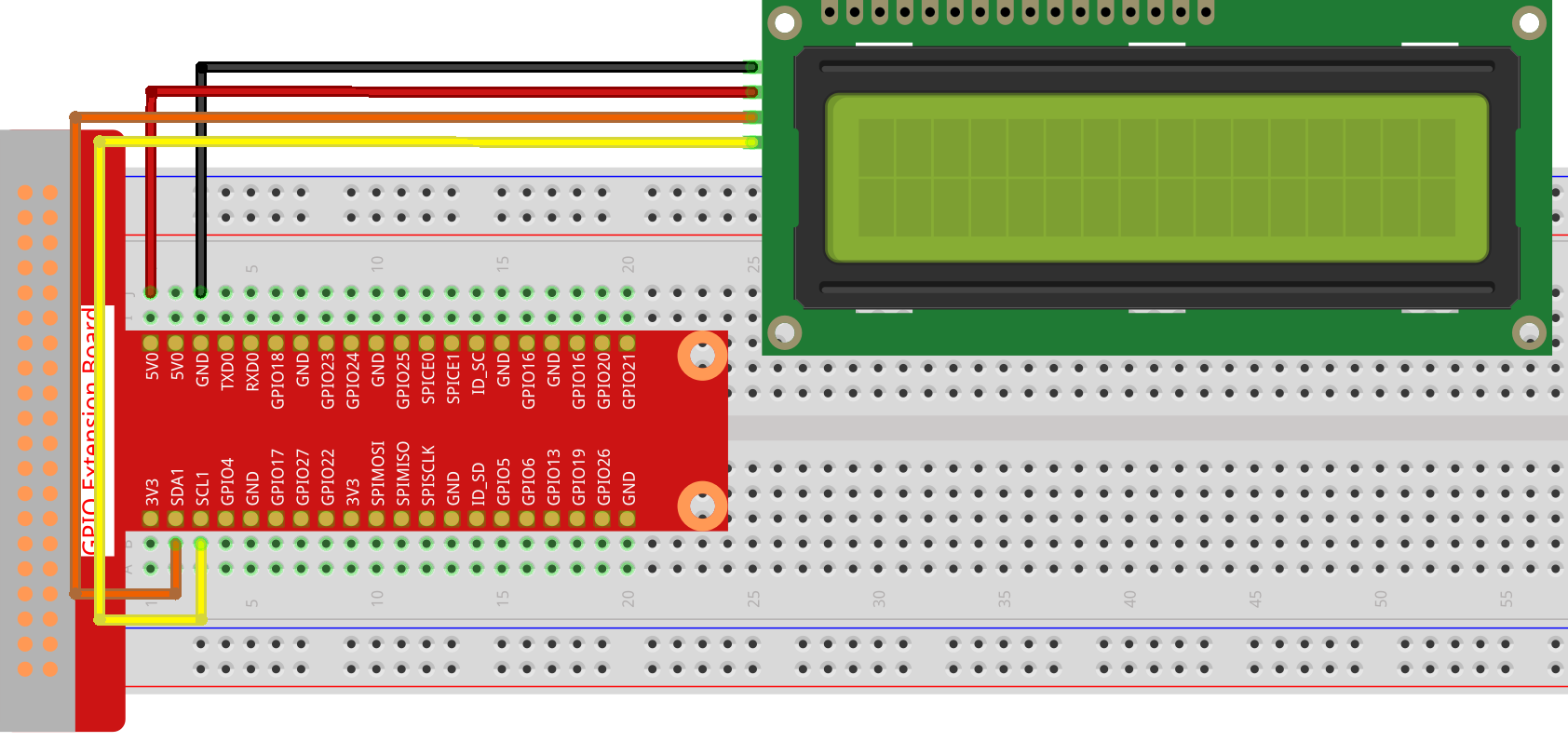

Step 1: Build the circuit.
../_images/image961.png

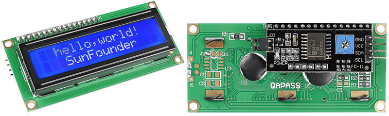

After the code runs, you can see "Greetings","From SunFounder" displaying on the LCD.
  • If there is an error prompt wiringPi.h: No such file or directory, please refer to Install and Check the WiringPi.
  • If you get Unable to open I2C device: No such file or directory error, you need to refer to I²C Configuration to enable I2C and check if the wiring is correct.
  • If the code and wiring are fine, but the LCD still does not display content, you can turn the potentiometer on the back to increase the contrast.
