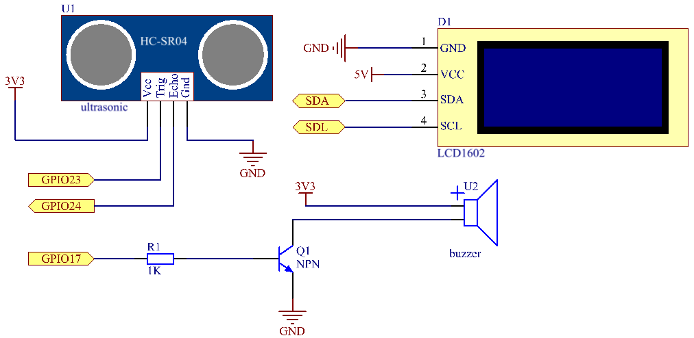

Schematic Diagram
Ultrasonic sensor detects the distance between itself and the obstacle that will be displayed on the LCD in the form of code. At the same time, the ultrasonic sensor let the buzzer issue prompt sound of different frequency according to different distance value.
T-Board Name
physical
wiringPi
GPIO23
Pin 16
23
GPIO24
Pin 18
24
GPIO17
Pin 11
0
17
SDA1
Pin 3
SCL1
Pin 5
../_images/Schematic_three_one31.png
